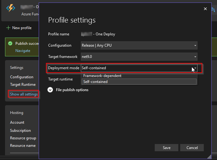

    Solution:
    Restarted the Visual Studio
    Created new publish profile=> Go to settings (show all settings)=> Select Deployment mode as Self-contained under Profile settings=> Publish.
    Able to deploy the function to Azure using both framework-dependent and self-contained deployment modes.
    Hope this helps!
