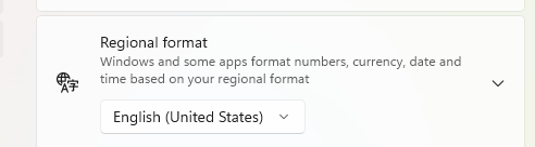

Running the following script code:
winget install --id Microsoft.SQLServer.2025.Express -s winget
Echos the following message:
Microsoft (R) SQL Server Installer
Copyright (c) 2025 Microsoft. All rights reserved.
Operation finished with result: Failure
Oops...
Unable to install SQL Server (setup.exe). This SQL Server setup media does not support the language of the OS, or does not have the SQL Server English-language version installation files.Use the matching language-specific SQL Server media; or install both the language specific MUI and change the format and system locales through the regional settings in the control panel.
SQL SERVER INSTALL LOG FOLDER
C:\Program Files\Microsoft SQL Server\170\Setup Bootstrap\Log\20260226_155233
安装程序失败,退出代码为: 2227437582
