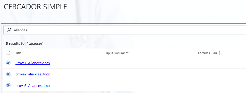

This is the NBS search term without any information in the columns:

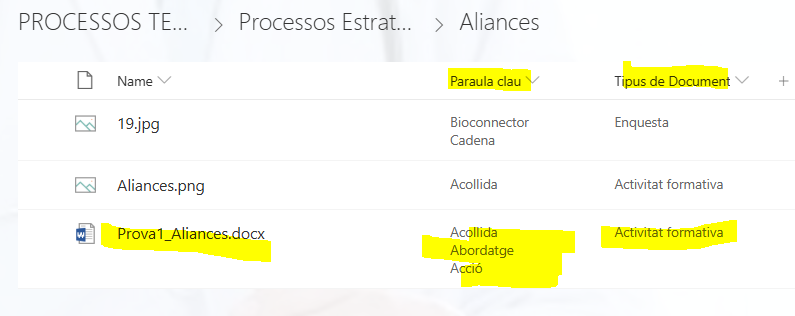

User's image This is the library with the same columns in the nbs, but filled.
