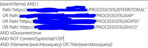

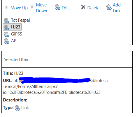

So I created multiple libraries in a Main page in SharePoint On-Premise, instead of only one.

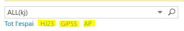

I have a Searcher
Right now it was looking on 1 library:
Now I need to look at 4 different libraries the same searcher, is it possible? How could I do it?

    As far as I know, in SharePoint On-Premises, a “searcher” (Search Results / Content Search / modern search results web part) typically uses a query template that is currently scoped to a single document library (for example, using a Path:"…/LibraryName" restriction).

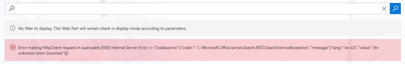

    That said, there is possibility that after you created additional libraries, the same search box will still only return results from the original library until you update the query to include all required library locations (or switch to a Result Source that already scopes to them). If the query syntax is not valid (often due to incorrect Path formatting or encoding), the Search REST call can fail and surface a generic 500 “unknown error.”
    In this situation based on your requirement, I suggest that you can try the first 2 options below to see if it can help you:
    Option 1: Use KQL with multiple Path
    If your “Searcher” is using SharePoint Search with a Query template, update the query template to:
    {searchTerms} AND (
      Path:"https://yourserver/sites/yoursite/Library1"
      OR Path:"https://yourserver/sites/yoursite/Library2"
      OR Path:"https://yourserver/sites/yoursite/Library3"
      OR Path:"https://yourserver/sites/yoursite/Library4"
