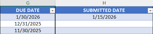

Hello all,
I was asked to create a spreadsheet in which the dates entered in different cells cause them change colors.
The first thing asked was to have the cells in Column G turn red when the date entered is older than today's date, turn orange when within 15 days of today's date, and remain unchanged when after/not within 15 days of today's date.
I was able to do this just fine with conditional formatting.
User's image User's image

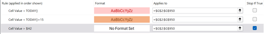

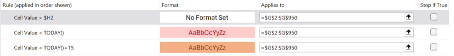

I've tried adding a condition to remove cell formatting when the date value in Column G is greater than the date value in Column H. Placing it above the other formatting in the rules manager does not remove the formatting.

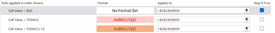

Marking this rule Stop if True does remove the formatting, but then it also removes the formatting in Column G for all subsequent rows that do not have a date filled in Column H yet, which I do not want.

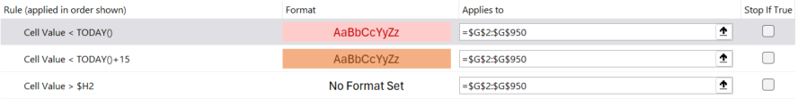

Putting this rule below the other two rules does nothing to remove the formatting, whether Stop if True is marked or not.
Playing around with the order/stop if true marks of these rules doesn't have the results I want, which is the color formatting in Column G to stay when Column H is empty/has a date after the date in Column G, and for the color formatting to go away when Column H has a date before the date in Column G.

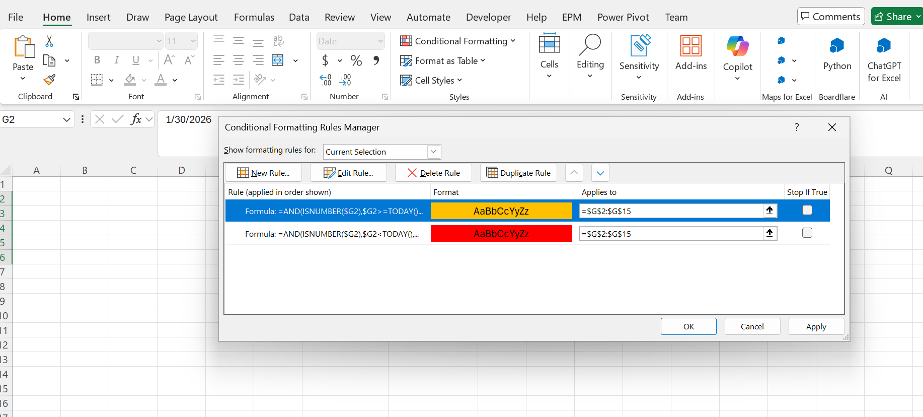

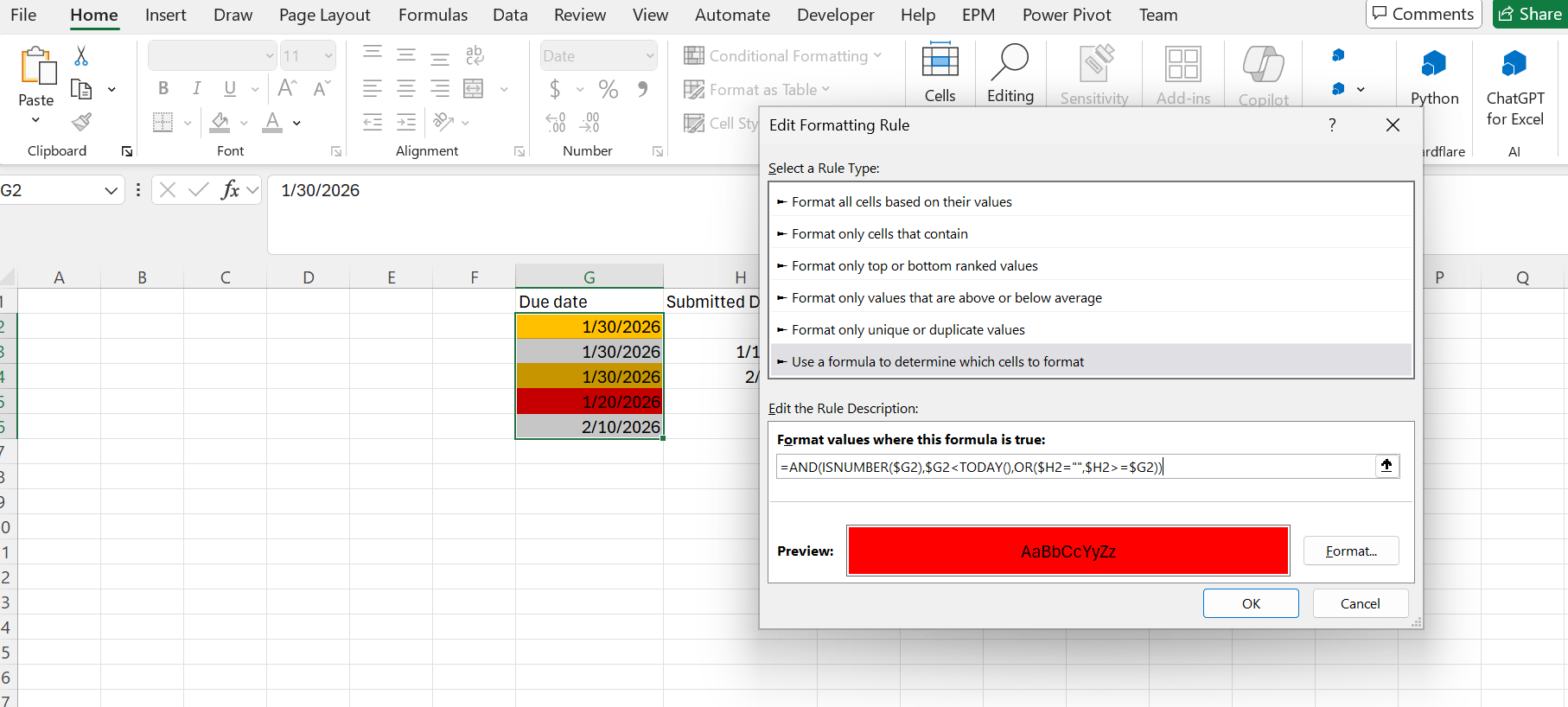

    According to your concern, if the formatting required additional date comparison with column H, you need to set up an additional condition to your current existing conditional formatting rules. Based on your sharing, you can try using these two conditional formatting rules:
    • For the Red rule, select the applied range > Condition formatting > New Rule > use a formula to determine...
    • Then use this formula:
        =AND(ISNUMBER($G2),$G2<TODAY(),OR($H2="",$H2>=$G2))
    • Set the fill color to your preference and click OK to apply the rule
    • Next is the orange rule, now you select New rule in the Conditional Formatting Rules Manager dialog box > also choose Use a formula to determine...
    • For orange, you use this formula:
        =AND(ISNUMBER($G2),$G2>=TODAY(),$G2<=TODAY()+15,OR($H2="",$H2>$G2))
    • Set the fill color to your preference and click OK to apply the rule. At the end you will have two conditional formatting rules like this:

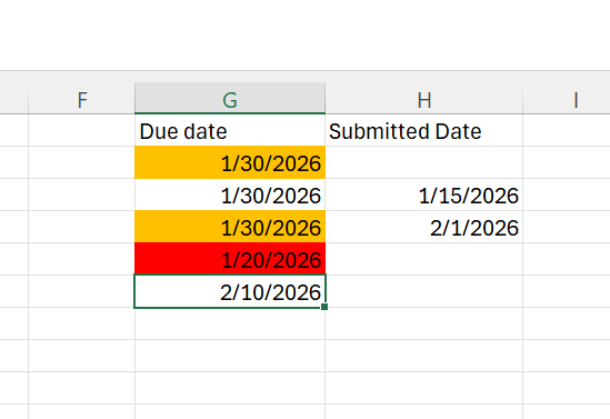

    • These rules require column G stores real dates, not text. However, based on your sharing that column G is formulated to import the date values and the comparison with TODAY() function in your original response works properly, there should be no problem.
