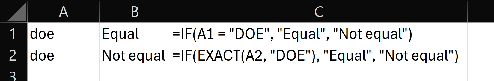

When comparing string value in an IF statement, does it matter if the string is all uppercase or not?
EXAMPLE: IF lastname = "Doe" OR lastname = "DOE" Then.....
I am just wondering if it matters or do I actually need to check both like the above code is doing.

  2. riny 20,765 Reputation points Volunteer Moderator
    2026-01-20T16:27:33.6233333+00:00
    Not sure why you accepted a nonsense AI answer. IF in Excel is NOT case sensitive. Try it and you'll see for yourself. Though, there are functions that are case sensitive in Excel. For instance, FIND is but SEARCH is not. Please un-accept the AI answer and delete it.
