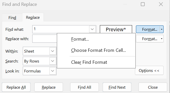

    According to your concern, if the VBA script is not a suspected one, you can try checking the Find/Replace dialog settings:
    • Click Ctrl+H in Excel to open the dialog box and click Options
    • In Find tab, ensure Match case and Match entire cell contents are both set to OFF
    • Next go to Find and Replace tab, also ensure Match case and Match entire cell contents are both set to OFF.
    • If any Format is set, click the dropdown next to Format > choose Clear Find/Replace Format
    Then you can try using the feature again to see if it works properly now. If you have any update regarding the issue, please share me in the comments of this port and I’ll be happy to continue supporting you.

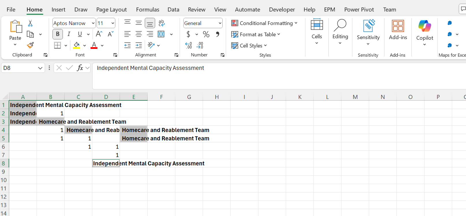

  3. Chris K 40 Reputation points
    2026-01-16T12:17:14.03+00:00
    Duplicated
  4. Chris K 40 Reputation points
    2026-01-16T12:26:32.4833333+00:00
    Ive confirmed that my macro that's causing this problem so Ive included a short version here in case theres anything obviously causing it. The macro works fine and has done for years btw.
    One thing I can see but I cant figure out how to turn error checking back on? I thought it was "Onerror Off" but i get a syntax error

  5. Hendrix-C 10,195 Reputation points Microsoft External Staff Moderator
    2026-01-20T15:37:49.4933333+00:00
    Hi @Chris K,
    I have tested your VBA script in several devices, and I confirm that your VBA makes Find Replace not working properly. The reason is your VBA uses Range.Replace, which save key search settings (like LookAt, SearchOrder, etc.) whenever you run it. Since Excel remembers Replace settings globally, those saved settings are shared with the regular Find/Replace dialog which can cause it behaving differently.
    About your syntax error, that's because you are having a -------------------------------- line with wrong syntax. If you want to add a line to distinguish script parts, you need to use '---------------------------- instead.
    To make your script and Find Replace both work properly, you need to reset the Find/Replace state after your macro. You can try this script:
