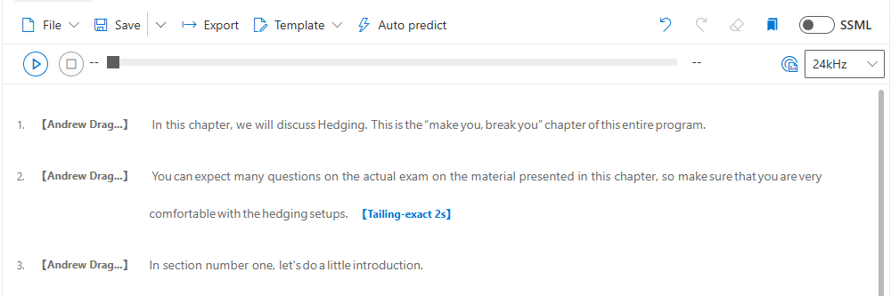

I'm trying to add silence in my text to speech files (see image below), but the silence tags will not actually generate the specified silence where I input them when I preview the audio. The silence doesn't show up in the exported output either. Am I doing something wrong?

    I can't even get it to add a silence. It just stays grayed out no matter what I highlight or where i place the cursor. The above suggestion did not help.

    It sounds like you're having trouble getting silence to work correctly in your text-to-speech files. Here are a few things you can check:
    1. Using the Correct SSML Tags: Make sure you're using the <mstts:silence> tag correctly. Silence can only be applied at the beginning or end of the text, or between two adjacent sentences. If you're placing the tag in a location that doesn't meet these criteria, it might not work as expected.
    2. Syntax and Attributes: Verify that the attributes used with the <mstts:silence> element are correct. If the attributes are incorrect or unsupported, the silence might not be inserted. You can refer to the SSML document structure and events for more details.
    3. Export Settings: If the silence is appearing in the preview but not in the exported output, double-check the export settings or any limitations in the tool you’re using. Sometimes, certain configurations might not support all SSML features, which can cause issues.
