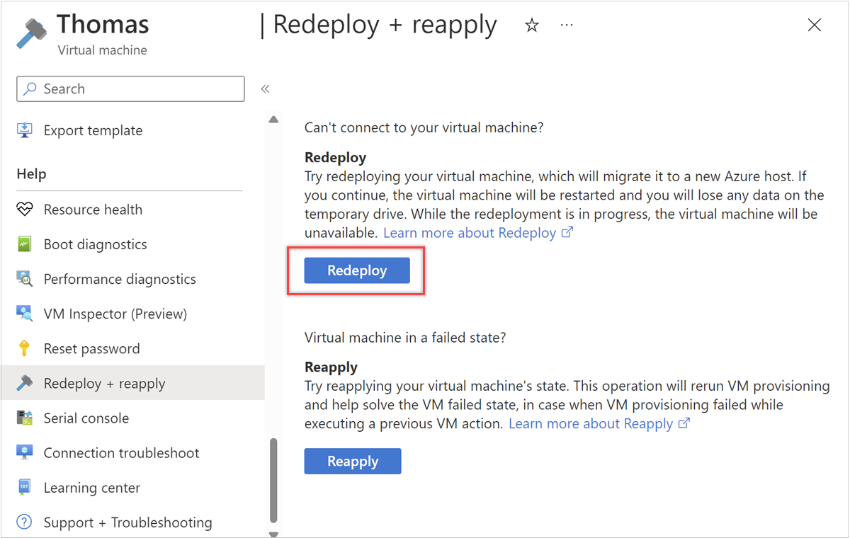

    • Performing Redeploy on the VM.
    These events can change the hardware identifiers (like SMBIOS System UUID) that your server-based license uses to fingerprint the host, potentially causing license invalidation.
