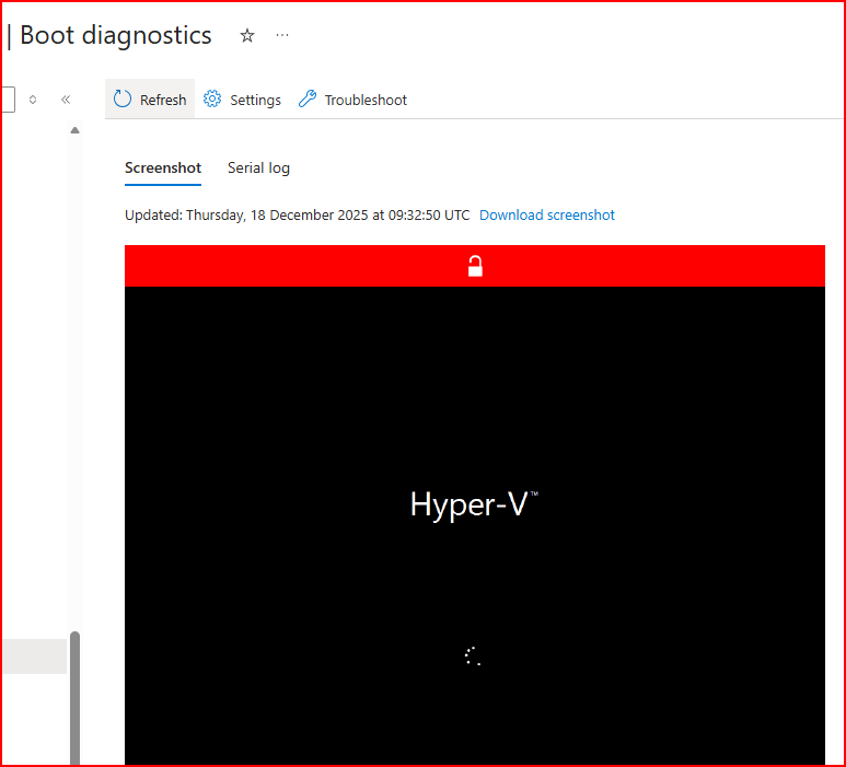

Having issue to connect to an azure vm, please help to provide details on the troubleshooting steps

  2. Ankit Yadav 7,945 Reputation points Microsoft External Staff Moderator
    2025-12-22T16:26:52.2966667+00:00
    Hey Fen Yang, The VM is failing to boot the guest OS and is stuck at the Hyper‑V splash screen, so this is an OS‑level boot/driver problem blocking your RDP operation with the VM.
    Likely root causes
    Quick mitigations to try:
    • Stop (deallocate) and then start the VM instead of only rebooting, and see if the screenshot in boot diagnostics change.
    • Try a different compatible VM size and start it again; in some recent incidents, a resize alone has brought VMs stuck at the Hyper‑V logo back to normal.​
    If these don't help, try checking and repairing disk/system files using Serial Console.
    • Connect via the Serial Console (under Support + Troubleshooting in portal).
    • Use command prompt and login to the VM.
    • Then run below commands one by one:
        chkdsk /f
      //above command is used to check disk integrity
        sfc /scannow
      //above command is used to repair system files
    If issue is still there, try repair path using Repair VM:-
    • Use Azure VM repair (portal or az vm repair) to automatically:
      • Create a rescue VM,
      • Detach the broken OS disk, attach it to the rescue VM, and mount it for offline repair.​
    • On the rescue VM, perform offline fixes on the attached OS disk, for example:
      • Remove or roll back recent problematic updates (uninstall from the offline Windows image).
      • Check and repair file system and boot files using tools like chkdsk and sfc against the offline Windows folder.​
    If repair also fails:-
    • Restore the VM from a recent backup or snapshot, which is the fastest way to recover if the OS disk is badly corrupted or repeated repair attempts fail.​
    • As a last resort, create a new VM and swap in the data disks from the faulty VM so user data is preserved even if the OS disk must be discarded.
