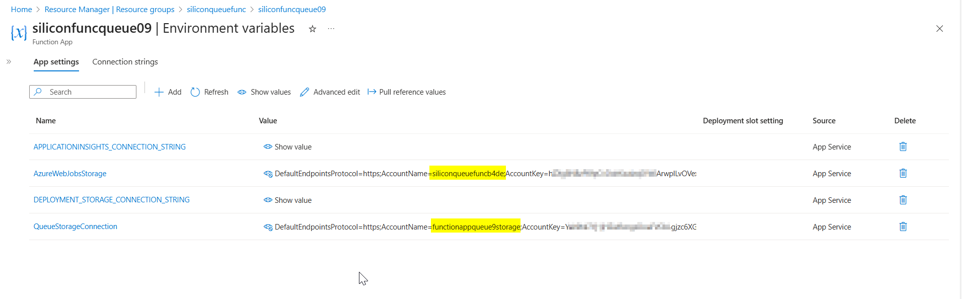

    Function App Settings:
    My Function app storage account and Queue Storage account is different and added the Connection string of both in the settings like below:
        "name": "AzureWebJobsStorage",
        "value": "DefaultEndpointsProtocol=https;AccountName=silxxxxxxxe;AccountKey=xxxxxxxx==;EndpointSuffix=core.windows.net",
        "slotSetting": false
        "name": "DEPLOYMENT_STORAGE_CONNECTION_STRING",
        "value": "DefaultEndpointsProtocol=https;AccountName=silxxxxx;AccountKey=xxxxxx;EndpointSuffix=core.windows.net",
        "name": "QueueStorageConnection",
        "value": "DefaultEndpointsProtocol=https;AccountName=funxxxxxxxxe;AccountKey=xxxxxxxxx;EndpointSuffix=core.windows.net",

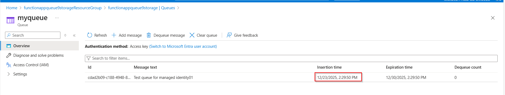

    Now, When I manually send one test message from my queue and check the Function App Invocation the Invocation is visible:
    Try sending the queue message manually and see if the Function triggers,

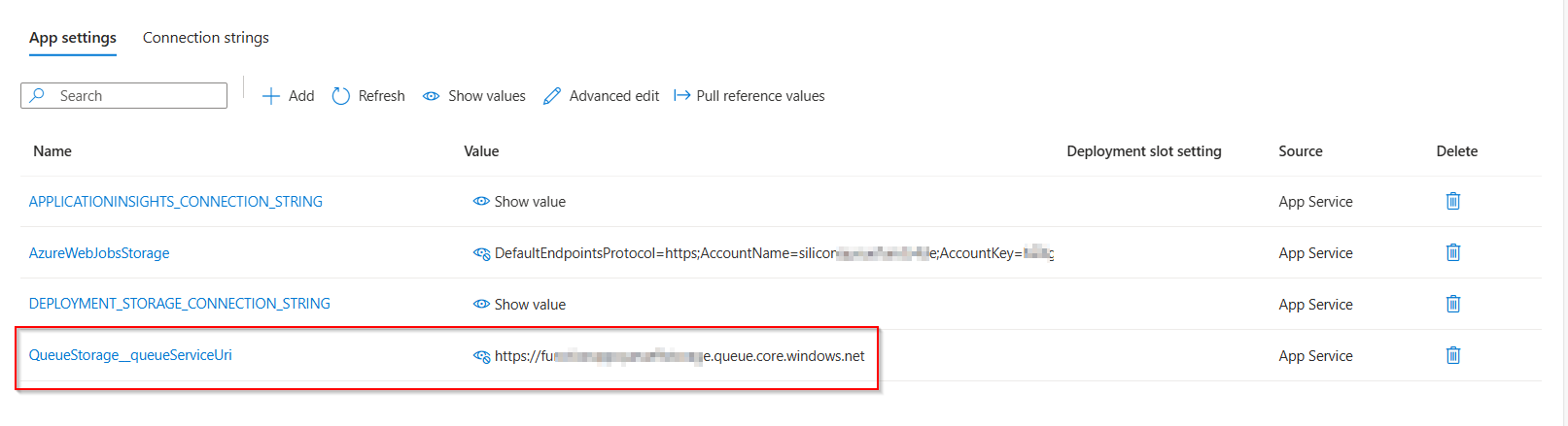

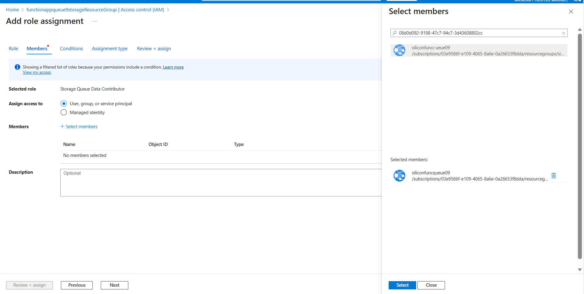

    Also if you want to perform the same steps with managed Identity add the below settings with Storage Queue Data Contributor role and change the binding in Function.cs file like below:-
    Function app setting:
        "name": "QueueStorage__queueServiceUri",
        "value": "https://storageaccountnamexxx.queue.core.windows.net",
    The key-value of managed identity setting should be
    QueueStorage__queueServiceUri: "https://storageaccountnamexxx.queue.core.windows.net"

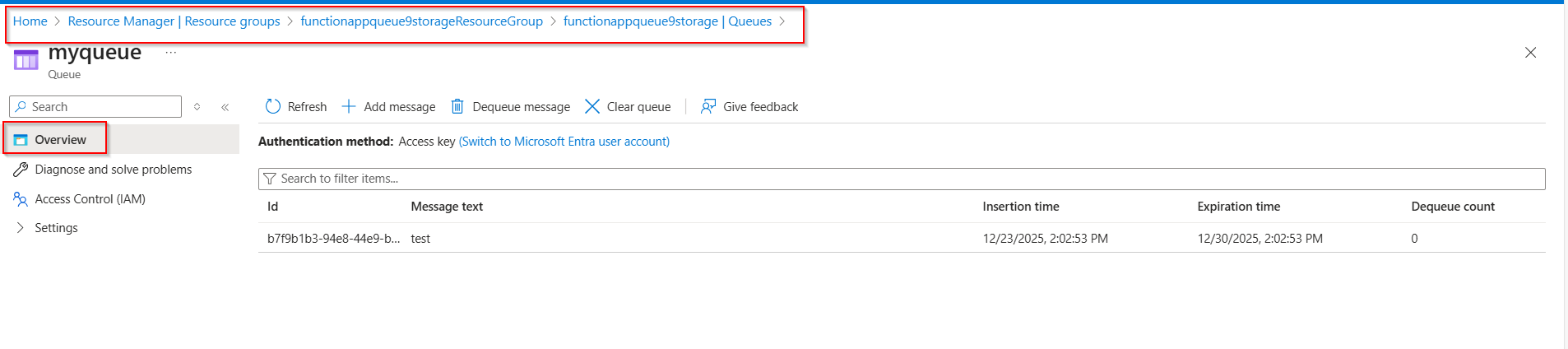

    The Function got triggered successfully when I sent queue with managed identity setting:
