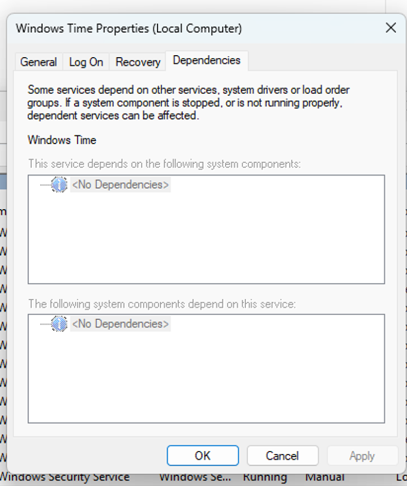

    2 - If it still shows Local CMOS Clock
    • Press Win + R > enter services.msc > find and double-click Windows Time
    • In Dependencies tab, ensure Remote Procedure Call (RPC) or similar is Running

  5. SacBat 0 Reputation points
    2025-12-05T18:32:29.7533333+00:00
    C:\Windows\System32>sc config w32time start= auto
    [SC] OpenService FAILED 1060:
    The specified service does not exist as an installed service.
