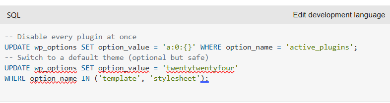

- While the scale-up is in progress, disable all plugins directly in the database. This will prevent WooCommerce from overloading the API and should allow the dashboard to load, even if other issues persist. Please access Azure Database for MySQL and navigate to the Query Editor, or use phpMyAdmin if available. Execute the following two statements, ensuring you replace 'wp_' with your actual table prefix if it differs.
- Please refresh your site; both the homepage and /wp-admin should now be loading correctly.
