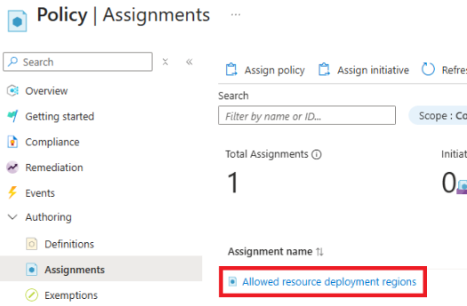

    Step 1: Find Your "Allowed" Regions
    1. Log in to the Azure Portal.
    2. Search for and open "Policy".
    3. In the left menu, click Assignments.
    4. Look for an assignment named "Allowed resource deployment regions" (or similar). Click on it.
    5. Click the "Parameters" tab.
    6. You will see a list of regions (e.g., eastus, centralus, westeurope). Write these down. These are the only places you can create resources.
