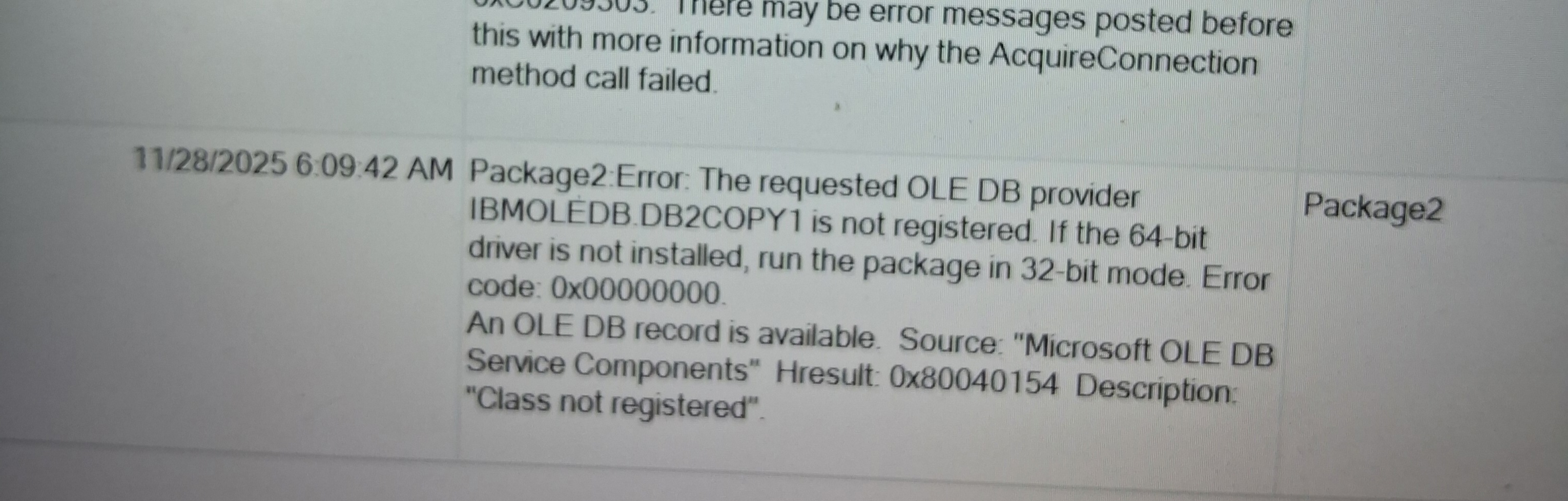

I am trying to run an SSIS package in Azure Data Factory using an SSIS Integration Runtime. The SSIS package uses IBM DB2 as the source and SQL MI as the destination. However, the package execution is failing due to a DB2 connection issue.
According to Microsoft documentation, the OLE DB configuration for IBM DB2 should already be pre-installed in the SSIS IR, but for some reason, the connection is still failing. I also attempted to configure a custom setup, but the PowerShell installation script is not working as expected.
Could you please guide me on how to resolve this issue? I especially need help with creating a proper custom setup to install the IBM DB2 OLE DB drivers using a PowerShell script in Azure SSIS IR.

    You can customize your Azure-SQL Server Integration Services (SSIS) Integration Runtime (IR) in Azure Data Factory (ADF) or Synapse Pipelines via custom setups. They allow you to add your own steps during the provisioning or reconfiguration of your Azure-SSIS IR.
    The IBM iSeries Access ODBC driver is not supported on the Azure-SSIS IR. You might see installation errors during your custom setup. If you do, contact IBM support for assistance.
