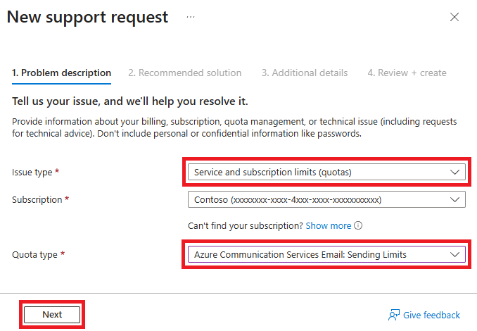

    5. Select Issue type: Service and subscription limits (quotas), Subscription: <subscription that needs quota increase>, Quota type: Azure Communication Services Email: Sending Limits, click Next
    support request Problem description tab

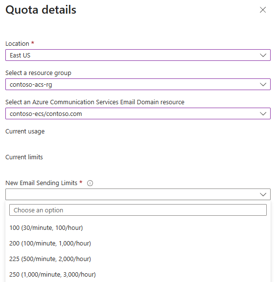

    7. On Additional details tab, click Enter details, select location, resource group, ACS Email domain resource, New Email sending limit you would like to request, confirm request by entering the tier enum (200, 225, 250, 275, 300, etc.) click Save and continue.
    enter image description here

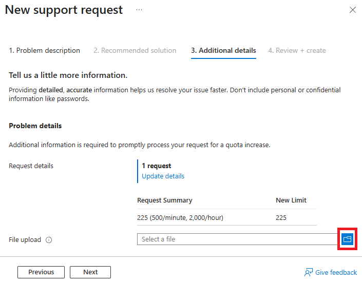

    8. Still on Additional details tab, click the blue file folder icon, select the .txt file you created above, and click Open to upload it.
