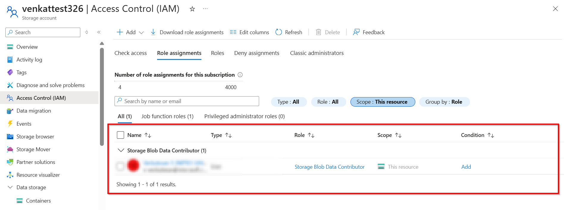

    • The Owner role grants resource management but not blob data operations like upload. Assign Storage Blob Data Contributor role to the user/service principal at the storage account or container scope via, Azure Portal > Storage Account > Access control (IAM) > Add role assignment. Verify effective permissions using the portal's "Check access" tool, as group/inherited roles may conflict. User's image
