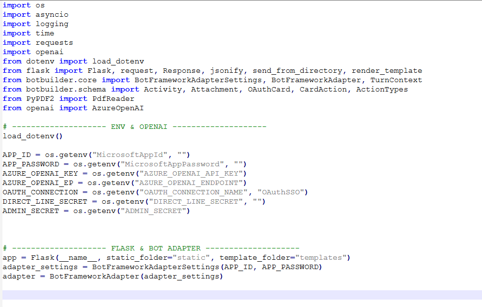

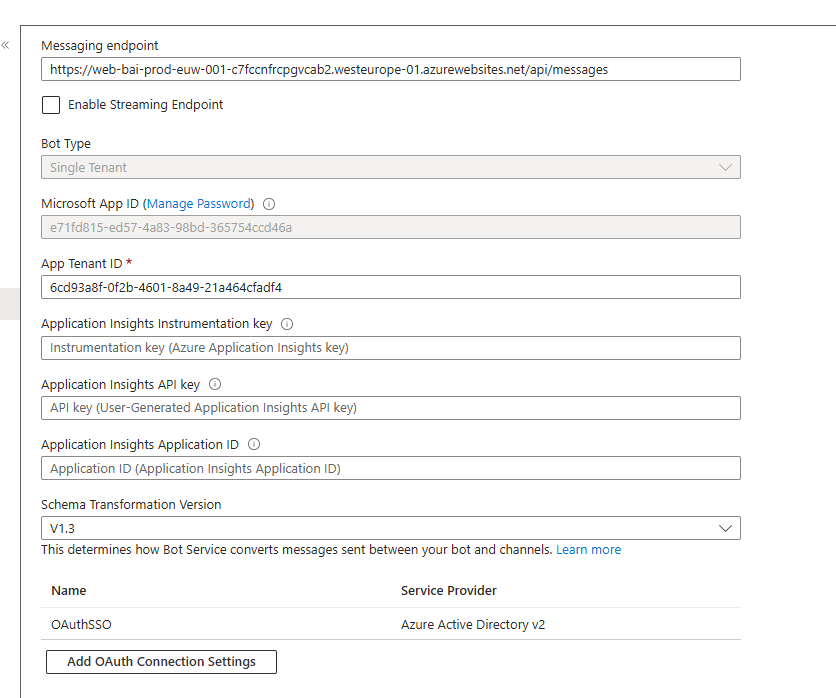

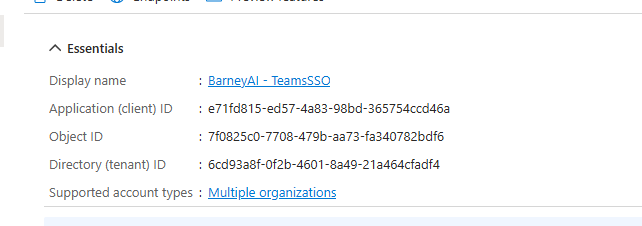

I am experiencing an authentication failure between Azure Bot Service and my Azure AD App Registration.
The bot is built with the Python Bot Framework SDK and works correctly in other environments.
However, in this Azure setup, Azure Bot Service cannot authenticate using the Microsoft App ID and secret, even though they are correct and freshly regenerated.

and sometimes when it switch to single tenant:
AADSTS700016: Application with identifier '{APP-ID}'
was not found in the directory 'Bot Framework'.
You may have sent the authentication request to the wrong tenant.
