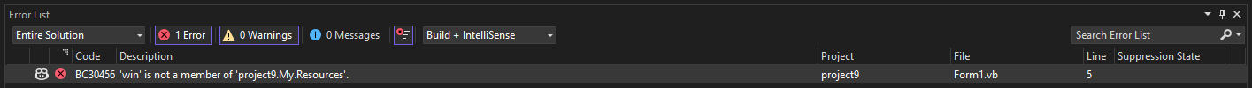

    I am also struggling with the exact same issue BC30456.
    {5608BC39-743C-4AA3-A71B-E4FB7CB410CB}
    This code used to work in older versions of Visual Studio 2022. I did try VS 2026 and I get the same problem.
    Public Class Form1
        Private Sub Form1_Load(sender As Object, e As EventArgs) Handles MyBase.Load
            My.Computer.Audio.Play(My.Resources.win, AudioPlayMode.BackgroundLoop)
        End Sub
    End Class

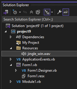

    I have added the Audio file in my resources:
    {CE69AD05-9484-498D-8B16-F47A8F206293}
    I can definitely see the audio in the Resources foder:
    {FF6679DA-8F30-4DC7-9512-3EE53E9E8B7F}
    I even tried to change 'Build Action' from 'None' to 'Resource', but still does not think my audio file is a member of my project...
    {E8BD7787-DAD2-40AE-869A-3B95631407C4}
