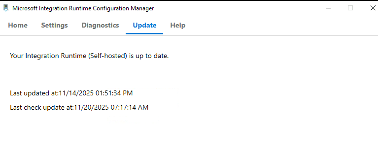

We have enabled auto-update for our self-hosted integration runtime. Initially, we deployed it with version '5.48.9076.1'. Over time, it was updated to '5.55.9315.1' via auto-update with our interventions. However, we've noticed that the latest available SHIR version is 5.60.9438.1, and our self-hosted integration runtime has not yet updated to this version. Is there a delay in the automated updates?

    There isn’t a “delay” bug—SHIR auto‑update works on a staged cadence. Microsoft ships monthly builds, but auto‑update pushes only a stable build from the prior quarter. So your node on 5.55.9315.1 can correctly show “up to date” even when 5.60.9438.1 is the newest download. If you want 5.60 now, upgrade manually. [learn.microsoft.com]
    Auto‑update vs. latest: ADF releases monthly; auto‑update happens roughly every three months using a stability‑vetted version from the preceding months. That’s why the portal/client can say “up to date” on 5.55 while 5.60 is available in the download center. [learn.microsoft.com], [github.com]
