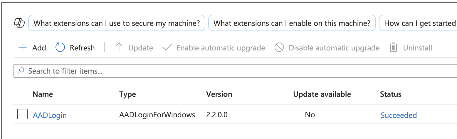

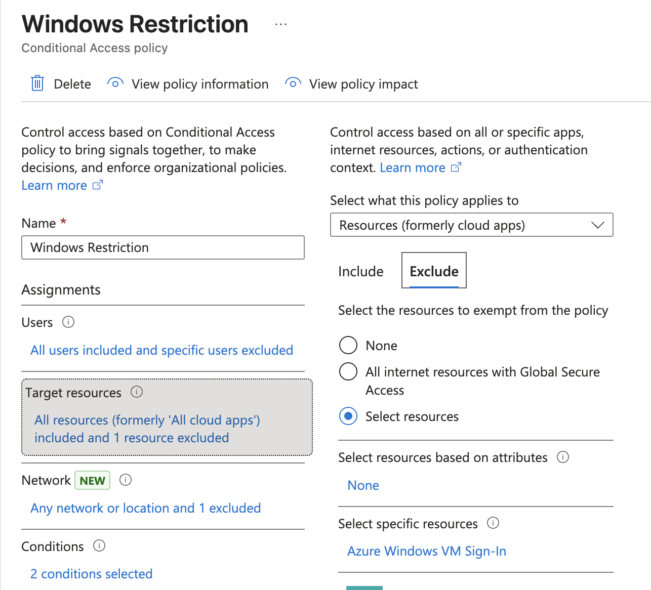

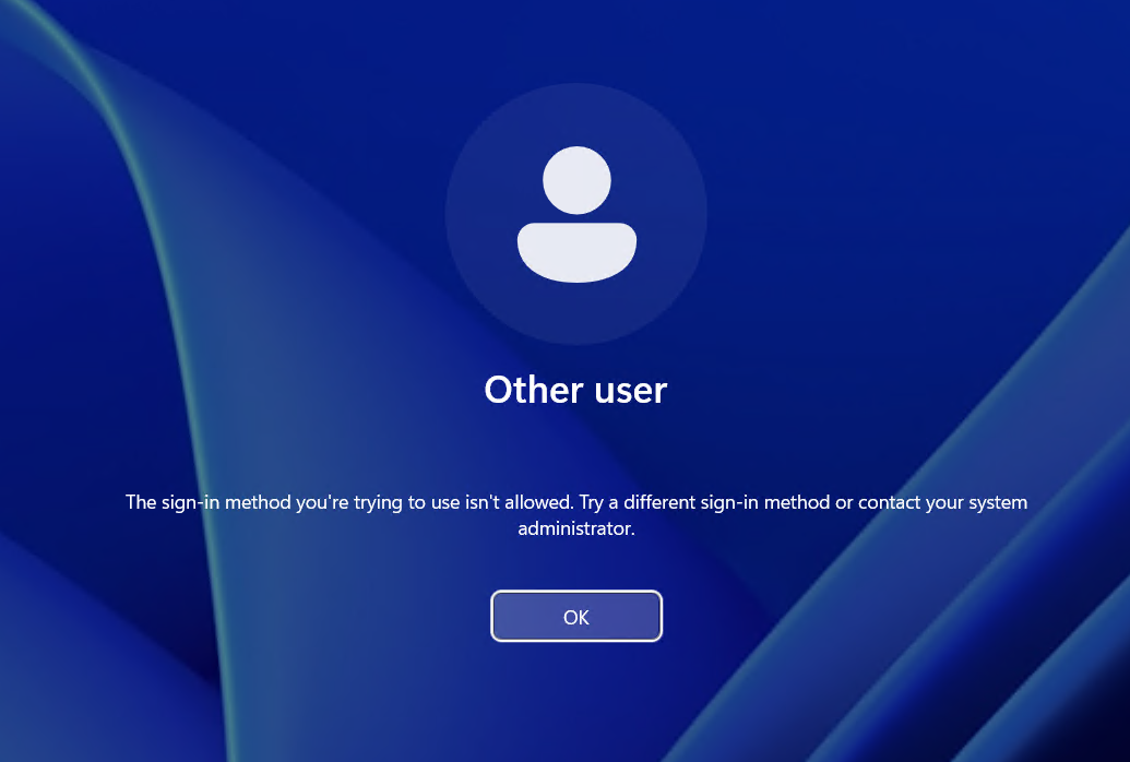

We setup a local on-prem hosted Azure Arc enabled VM such that users can RDP into the PC using their entra credentials with the "Entra login for windows extension" enabled. We also have a conditional access policy that requires compliant device. Now given that Azure Arc enabled VM is not Intune enrolled and thus not compliant, the user is getting blocked to sign-in with this error. User's imageUser's image

    To resolve the issue where users are blocked from signing in due to the conditional access policy requiring a compliant device, you can either:
    1. Exclude the Azure Arc enabled VM from the conditional access policy:
      • Go to the Azure portal.
      • Navigate to Azure Active Directory > Security > Conditional Access.
      • Select the policy in question.
      • Under "Assignments," go to "Users and groups" and add the Azure Arc enabled VM to the exclusion list.
    2. Enroll the Azure Arc enabled VM in Intune:
      • Follow the steps to enroll the VM in Intune to ensure it meets compliance requirements.
    Choose the option that best fits your security and operational requirements.

    No — Azure Arc–enabled Windows Servers cannot be Intune (MDM)–enrolled, so they can’t report Device compliance for Conditional Access. Windows Server sign‑in with the Entra login for Windows extension is supported, but CA controls that require a compliant device aren’t supported for Windows Server sign‑ins, which is why your users are blocked.
    for you reference: https://docs.azure.cn/en-us/entra/identity/devices/howto-vm-sign-in-azure-ad-windows?pivots=identity-extension-vm
    What supported and what not supported according to microsoft:-
    1. Windows Server + Entra login (Arc or Azure VM): Microsoft explicitly states “Windows Server VMs don’t support MDM enrollment**.”** Therefore, they cannot be Intune‑compliant devices.
    2. Conditional Access: For Windows Server sign‑ins, device‑based CA (Require compliant device) is not supported. Use other signals such as MFA, sign‑in risk, location instead.
    3. Management path for servers: Use Azure Arc, Azure Policy (Guest Configuration/Machine Configuration), Azure Update Manager, and Microsoft Defender for Cloud / Defender for Endpoint for governance and security — not Intune MDM compliance.
    For your references: https://docs.azure.cn/en-us/entra/identity/devices/howto-vm-sign-in-azure-ad-windows?pivots=identity-extension-vm
