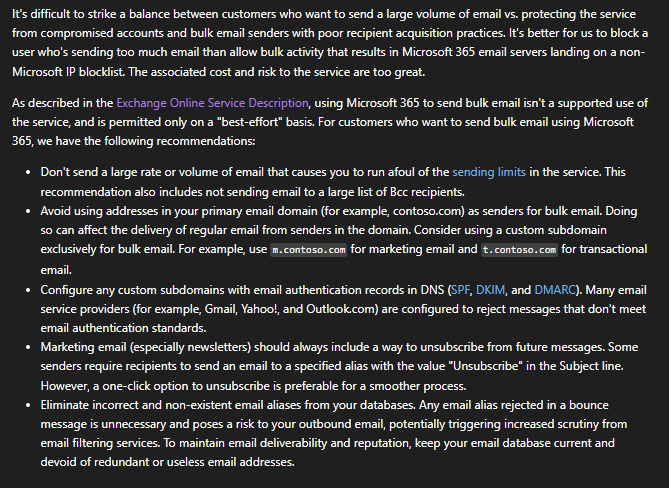

    According to this issue, please check if you've set up your DKIM based on this article (DKIM should be set up in Microsoft 365 Security Center - https://security.microsoft.com/ https://learn.microsoft.com/en-us/defender-office-365/email-authentication-dkim-configure?view=o365-worldwide#steps-to-manually-set-up-dkim
    You shouldn't be using Office 365 to send bulk emails. Please consider using a proper service that will handle bounces and unsubscribe requests for you automatically, which a manual list on Office355 cannot do. Someone probably wants off the list, and as there is no one click unsubscribe, they are marking the messages as spam.
    You could consider using this Postmaster Tool (from Google) and monitor if this could improve the situation: https://support.google.com/mail/answer/6227174?sjid=7925206490225307693-NC
