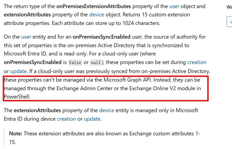

    From my research, I agree with you that the extension attribute property cannot be changed when it was previously synced from an on-premises Active Directory as read-only, since the source of authority for these properties is the on-premises environment. undefined
    Reference: onPremisesExtensionAttributes resource type - Microsoft Graph v1.0 | Microsoft Learn
    From the information above, one possible approach is to update the Customer Attribute mapped to ExtensionAttribute1 using Exchange Online or Exchange Online V2 PowerShell modules
    For example, you could combine this with your idea of using an API call and PowerShell command such as:
    Set-Mailbox -Identity ******@domain.com -CustomAttribute1 "NewValue"

    Another method, similar to your idea, is to update the extension attribute in the on-premises environment first and then sync it to the customer attribute. The automated flow would look like this:
    Trigger event => API => Execute PowerShell
    Set-ADUser -Identity $UserPrincipalName -Replace @{extensionAttribute1="NewValue"}
     => Sync to Azure AD => Custom attribute update
    Note: Make sure the Active Directory module is installed on the API host.
