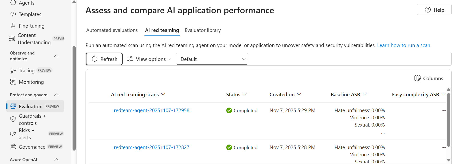

    Hi Karthickumar,
    Output can be seen in the Portal as shown below:
    However executing the below code will save the logs and a json of Result of Red Team Scan:

    If you are still facing an issue, please let me know by providing a screenshot of the error and the code you are using.
