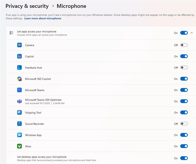

    1. Windows privacy settings
    • Go to Settings > Privacy & security > Microphone.
    • Make sure apps, especially Microsoft Teams, have permission to access the microphone. Sometimes, Windows privacy settings can block apps from using it.

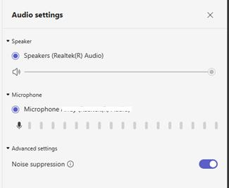

    1. Check Teams audio device settings
    While in a Microsoft Teams meeting:
    • Click More options (···) and select Audio settings.
    • Microphone: Choose the Surface Hub microphone, avoid selecting an external device or any option that’s disabled.
    • Speaker: Make sure the correct output device is selected.
