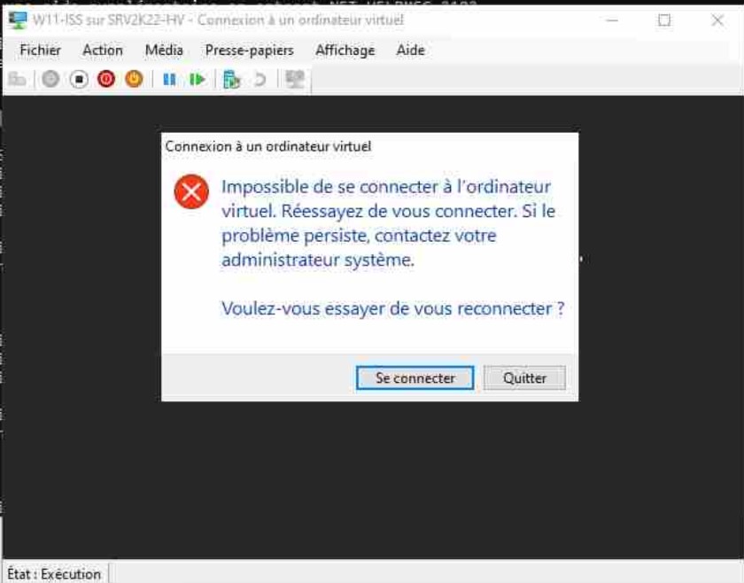

Hello everyone,
I've big issue with my hyper-v on windows server 2022.
I can't connect anymore with the console en Hyper-v manager.
All my VM are working as expected but it's not possible to use the VMCompute anymore to deploy new VM.
I've tried a lot of trick without any positive result. I've also tried with WAC with the same result.
I've seen this error in event logs but i can't start and stop Vmcompute services as expected, too.
Fault services: vmcompute.exe
Exception: 0xc0000194
Defective module: vmcompute.exe.
Already tried to disable Firewall and AV and so on.
Did you have an idea of what could happen?

  1. JasonTranNguyen-3858 1,240 Reputation points Independent Advisor
    2025-11-06T10:59:46.44+00:00
    Hi Christopher Migeot,
    The error code 0xc0000194 typically points to a failed initialization or missing component within the VM compute stack.
    Here are a few steps I recommend trying:
    First, open Services.msc, locate Hyper-V Host Compute Service, and ensure the startup type is set to Automatic. Try starting it manually.
    If it fails, open an elevated PowerShell window and run:
    sfc /scannow
    DISM /Online /Cleanup-Image /RestoreHealth
    These commands will check for and repair corrupted system files.
    Verify that all Hyper-V-related Windows features are enabled by running:
    dism /online /enable-feature /featurename:Microsoft-Hyper-V-All /all
    Check the folder C:\ProgramData\Microsoft\Windows\Hyper-V for permission issues — ensure SYSTEM and Administrators have full control.
    If the service still won’t start, you may need to re-register VMCompute using:
    net stop vmms
    net stop vmcompute
    del "%ProgramData%\Microsoft\Windows\Hyper-V" /F /S /Q
    net start vmms
    If everything looks correct and the issue persists, consider performing a repair installation of Windows Server 2022 while keeping roles and data intact.
