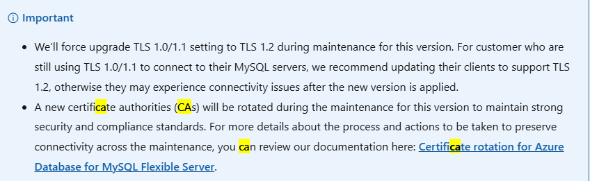

The link mentions "To maintain our security and compliance standards, we start changing the root certificates for Azure Database for MySQL Flexible Server after September 1, 2025."

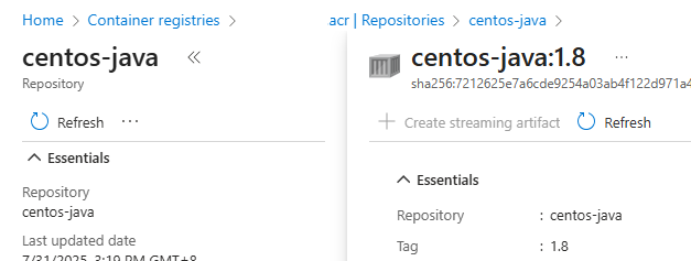

Background: My application is written in Java and utilizes Azure SQL and MySQL. It is currently deployed on AKS. The base image in the Dockerfile is centos-java:1.8.

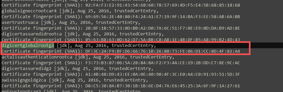

Issue: Before September 2025, I checked the Java Trusted Root Certificate Store in the base image file centos-java:1.8 as described in the Azure documentation.
It only contained the CA "DigiCert Global Root G2," and did not include the newly added "Microsoft ECC Root Certificate Authority 2017" and "Microsoft RSA Root Certificate Authority 2017."

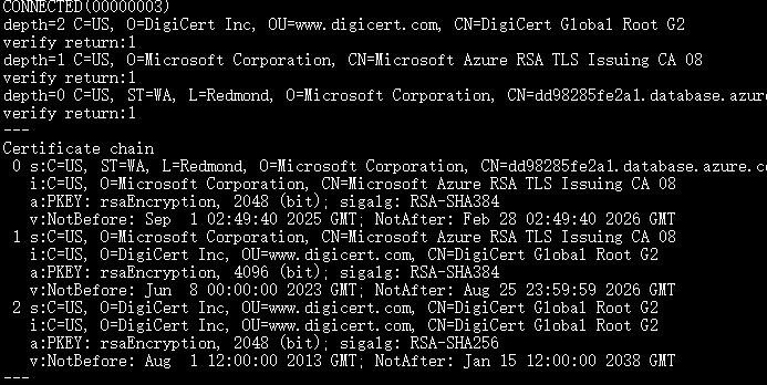

However, even now in November, when I tested removing these connection parameters, I found that I could still connect to the database, even though my base image file was missing "Microsoft ECC Root Certificate Authority 2017" and "Microsoft RSA Root Certificate Authority 2017."

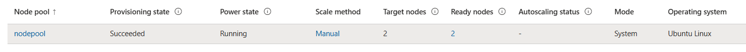

Unlike others, which normally run Java programs using VMs, we are using AKS, with the node pool system running Ubuntu Linux, and the pods built on the base image centos-java:1.8.

    Your Java application behavior results from AKS nodes running Ubuntu Linux, which may provide system-level certificates accessible to containers. Java, depending on its configuration, can fall back to system CA stores, especially in OpenJDK-based environments. To confirm this, you should inspect the certificate chain using openssl from bash command via your Azure CLI:
    openssl s_client -connect <your-db-host>:<port> -starttls mysql
    This will reveal whether the required Microsoft root certificates are being sourced from the host OS rather than the container’s Java trust store.

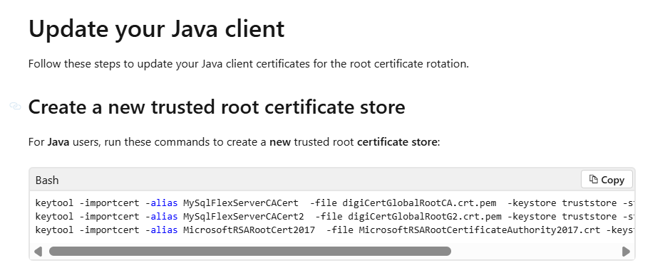

    To ensure long-term compliance and secure connectivity, you must explicitly add the Microsoft ECC and RSA root certificates to the Java trust store within the Docker image. This can be done using the keytool utility:
    keytool -import -trustcacerts -keystore $JAVA_HOME/lib/security/cacerts \
     -storepass changeit -noprompt -alias ms-ecc-root \
     -file Microsoft_ECC_Root_Certificate_Authority_2017.crt
     -storepass changeit -noprompt -alias ms-rsa-root \
     -file Microsoft_RSA_Root_Certificate_Authority_2017.crt
