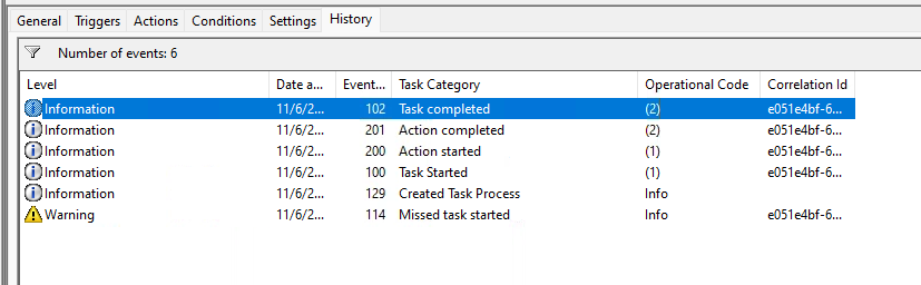

Task Scheduler is not running/executing on AVDs windows 11. They are a request to run auto log off user session daily at 9pm on Azure AVD because users are not logging off from their computers. I can create a task, but the task is not running, even if you click run manually still is not running. if I go to the logoff.exe file and run it runs and working but through Task Scheduler window is not executing at all. what could be the issue, what is blocking the execution of tasks.

    The screenshot you provided shows that a task was scheduled but experienced a "Missed task started" event, which could mean it didn’t trigger or run as planned. Here are some steps you can take to troubleshoot and possibly fix the issue:
    1. Missed Task Started Warning
    This warning indicates that the scheduled time for the task was missed, possibly because the PC was turned off or in sleep mode.
    To resolve this:
    • Ensure the task trigger is set correctly (e.g., daily at 9 PM).
    Open Task Scheduler and go to the Settings tab
    Select "Run task as soon as possible after a scheduled start is missed"
    Make sure your machine is awake and available during scheduled times.
    1. Verify Task Conditions tab
    Make sure options like “Start the task only if the computer is on power” or “Start only if the network connection is available” are disabled if they restrict execution.
    Allow the task to run “On demand” and not be stopped prematurely by conditions.
