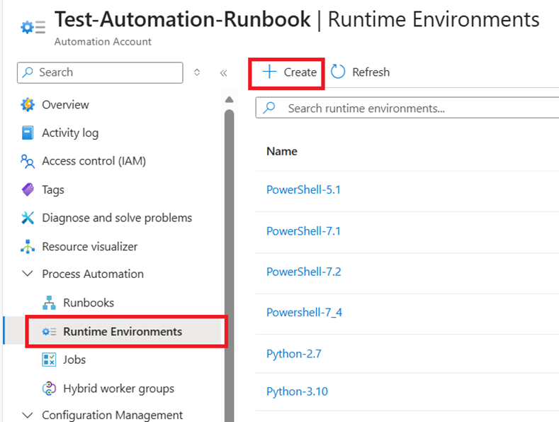

    1. Go to the Azure portal > select your Automation account.

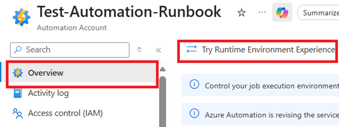

    2. Under Process Automation > select Runtime Environments. User's image If you don't find Runtime Environments in the list, select Try Runtime environment experience in the Overview page to switch to the new portal interface. User's image Then select Runtime Environments under Process Automation.
    3. Select Create to create a new PowerShell 7.4 Runtime.

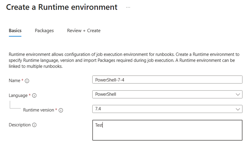

    4. On the Basics tab, provide the following details. User's image

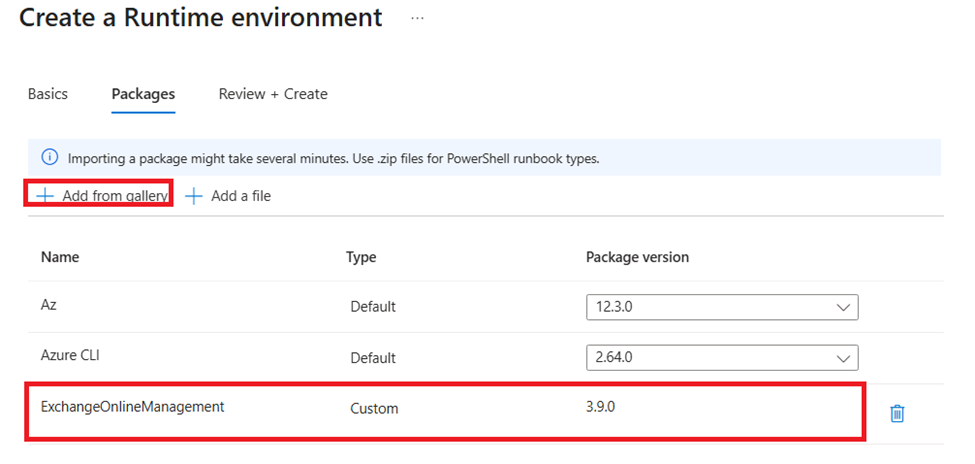

    5. On the Packages tab, in the Package version dropdown list, you would see default Az and Azure CLI packages already present.
    6. Select +Add from gallery to add more packages from gallery and select Next. User's image
    7. On the Review + create tab, review the entries and select Create.

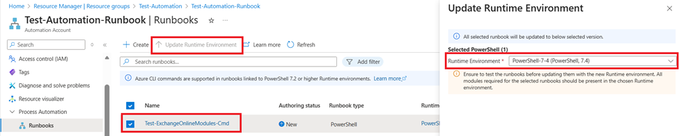

    1. Go to Azure portal > select you're In the Automation account > Runbooks page, select the runbook linked to old PowerShell Runtime environment that you want to update. Then click on Update Runtime Environment > select the new Runtime environment (PowerShell 7.4) > click update > click on refresh. You can see the Run time is update. User's image
    2. Make changes in the runbook code to ensure compatibility with PowerShell 7.4.
