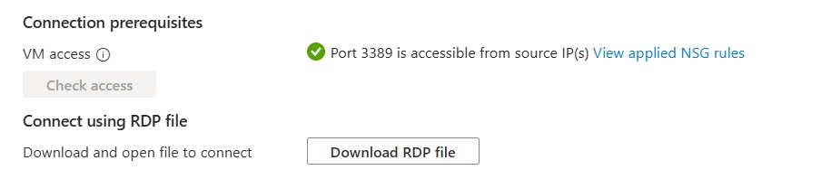

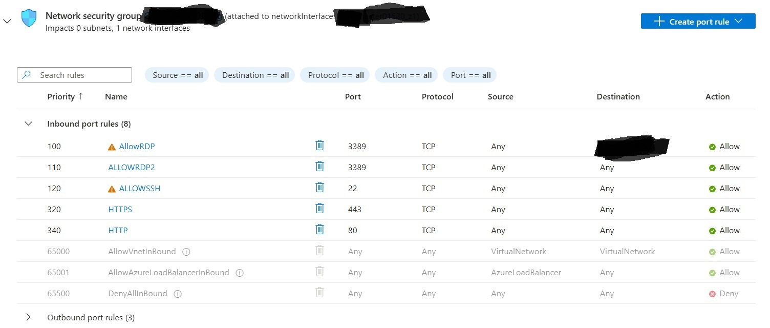

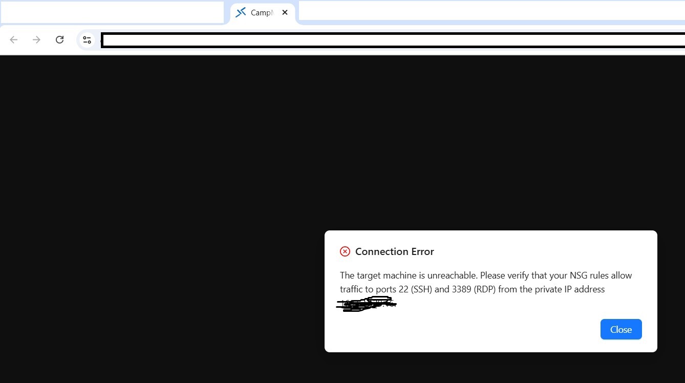

our customer who is using our software asked us to block RDP access to the server from anywhere, as a part of their security measurements, the step i took was to allow secured access to the server only on port 3389, so now the RDP is not accessible from anywhere as needed, so we have returned back to access the server from the Azure portal but the portal shows an error and not allowing to access the vm, although the software which is published on that server is working fine so the server is running, but it is only blocking all accesses, is there a way to revert the updates we have done, or steps to access the vm from the portal smoothly. i can provide more details if needed,

    • Please check if there is any NSG attached to the Bastion subnet and ensure it does not block any traffic.
    • Also, kindly review the NSG rules at both the NIC and subnet levels of the VM to confirm that the Bastion subnet's private range is not being blocked.
    • And also, please let me know any route table is associated to VM or Bastion subnets.

    1. Is there a firewall (Azure or any third party fw) in your environment and is it the next hop for traffic to internet and private IP address.
    You can verify by checking if there is any ROute table associated to your VM subnet and routes inside the route table, you can post the screenshot for reference.

    1. Since you are trying to access from Bastion, check any NSG or Route table on your Bastion subnet.
    NSG can block the traffic, whereas an incorrectly configured route table can misroute/blackhole your traffic.
    1. You can have NSG flow logs enabled on your VM NSG to see whether the traffic is hitting to this VM or not and take action accordingly.
    2. Most probably there would be one mode NSG (subnet level and NIC level) which is blocking the traffic.
