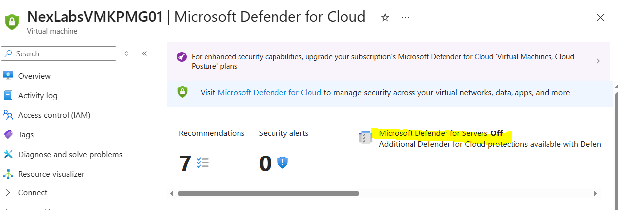

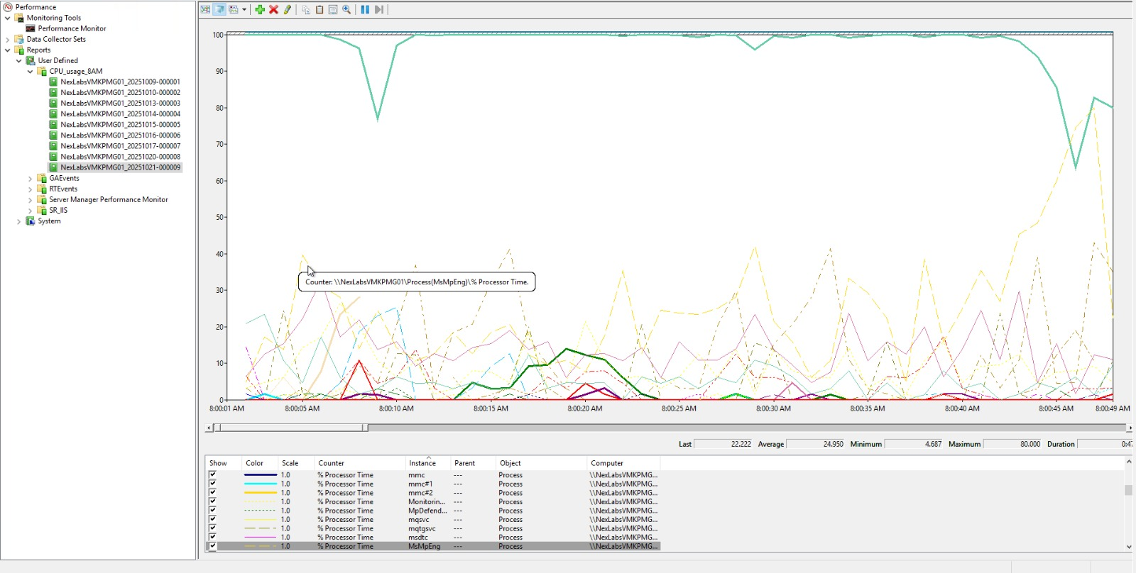

We have a VM where MS Defender has already been turned off, and we had also configured folders to be excluded from scanning. But the Windows Performance Monitor still showed the MsMpEng process consuming 40% CPU at 8am this morning. At other times, the process consumes little or no CPU.
Can you advise? Thank you.

    Please Run Process Monitor (ProcMon) during these spikes to see which files or folders the service is accessing, then add targeted exclusions.
