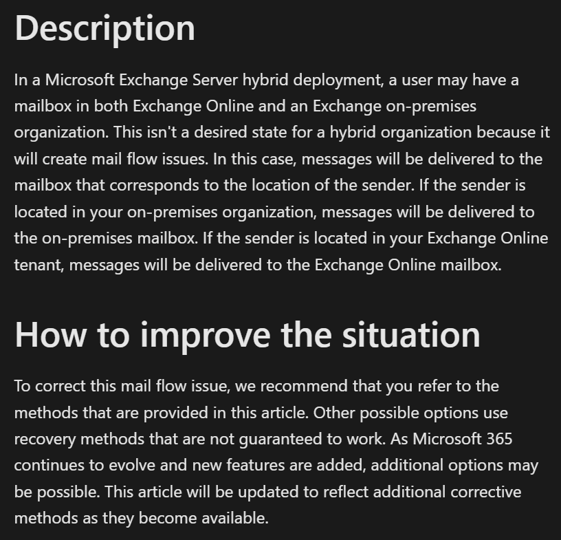

    Thank you for your message regarding the mail flow issue between Office 365 and your on-premises Exchange environment. Based on your description, it appears that the user ******@XXXX.com currently has two mailboxes, one in Exchange Online (Office 365) and one on-premises, and they have the same email address. This configuration may not supported by Microsoft, and it may lead to mail delivery issues, such as emails being delivered only to the cloud mailbox.

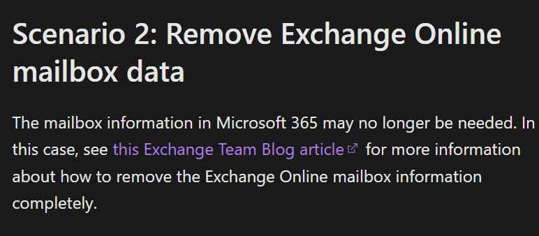

    Microsoft recommends that each user should have only one mailbox, either in Exchange Online or on-premises, to avoid such conflicts. You can refer to the official guidance here: How to recover when a mailbox exists in both Exchange Online and on-premises - Exchange | Microsoft…
    Also, you can consult more information in the link above (please kindly check scenario 2) and combine with suggested article in that section: Permanently Clear Previous Mailbox Info | Microsoft Community Hub
