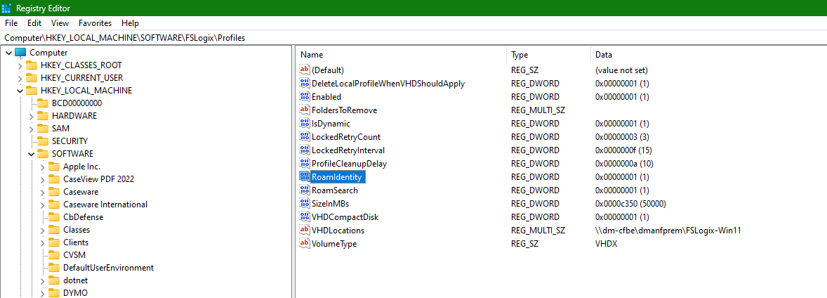

We've been having some intermittent problems with M365 apps (OneDrive, Outlook and MSTeams) in our Windows 11 23H2 Multisession AVD Environment. This is using the marketplace image /w M365 apps x64 gen 2. We use FSLogix (3.25.401.15305), profiles stored on an Azure NetApp File share, with the following registry settings on each host. We have about 15 hosts.

    Setting REG_DWORD RoamIdentity=1 in Computer\HKEY_LOCAL_MACHINE\SOFTWARE\FSLogix\Profiles - confirmed resolved the issue.
    Please note, this setting is only recommended in non-Intune managed or Entra-only joined environments. My environment is Hybrid Joined.
