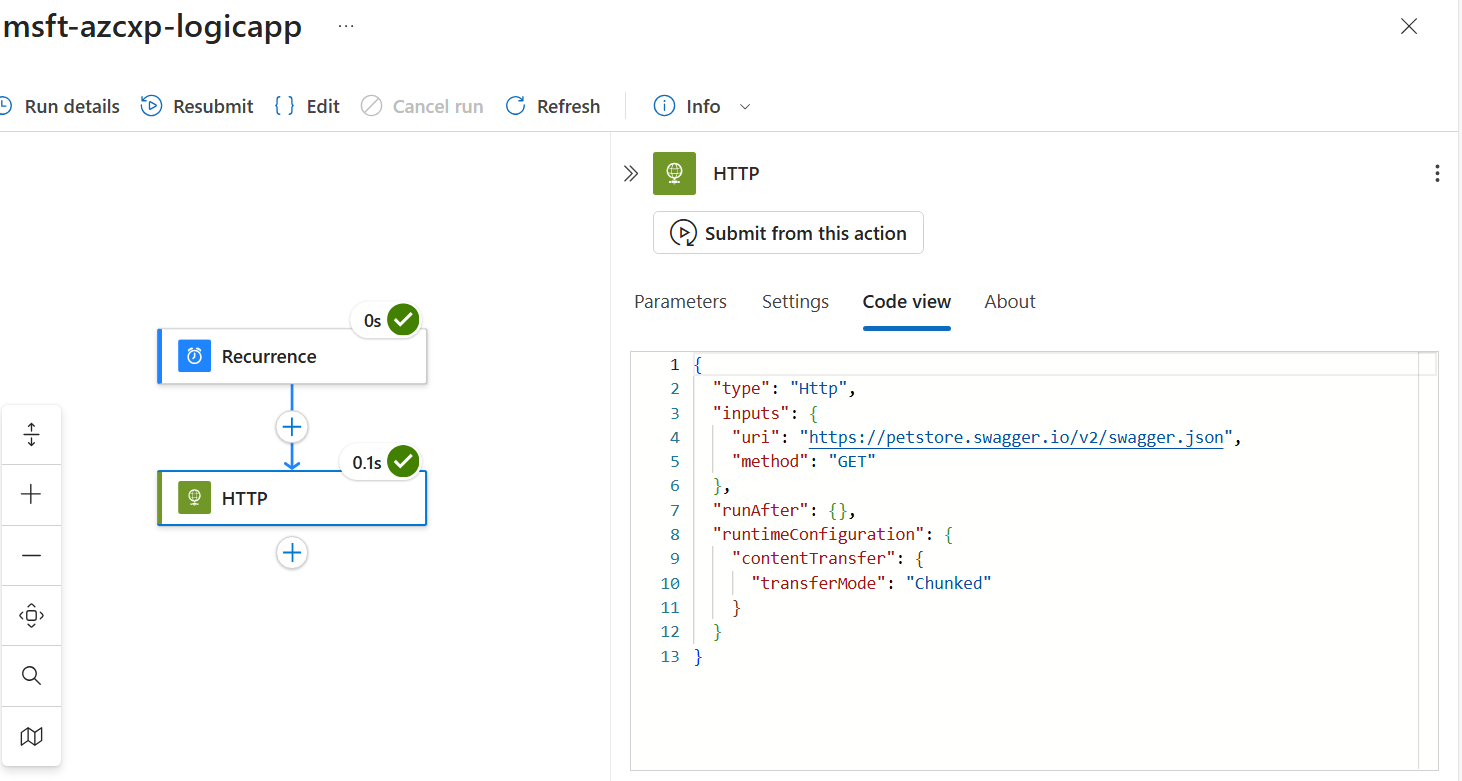

    • To test this behavior, I created a sample Logic App that fetch swagger definition, and it works fine for me. The Logic App uses the following steps:
    • Use the HTTP action to fetch swagger definition
    This may help you identify if the issue lies specifically with the HTTP + Swagger action.
