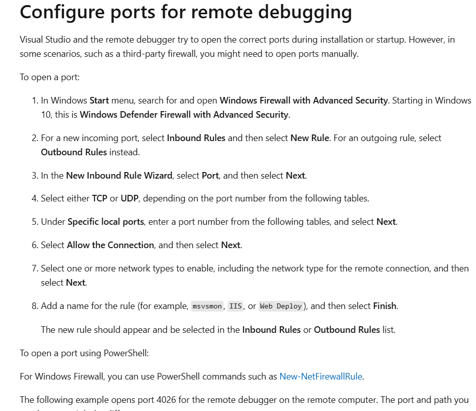

    The error you're encountering is related to a Windows security update that has likely tightened firewall rules, thereby blocking ports required for remote debugging using SQL Server (SS) or Visual Studio.
    You need to manually open the following ports in Windows Firewall.
    Find Microsoft documentation for additional information:
    https://learn.microsoft.com/en-us/visualstudio/debugger/configure-the-windows-firewall-for-remote-debugging?view=vs-2022#allow-the-remote-debugger-through-windows-firewall
    https://learn.microsoft.com/en-us/troubleshoot/developer/visualstudio/debuggers/troubleshooting-remote-debugging
