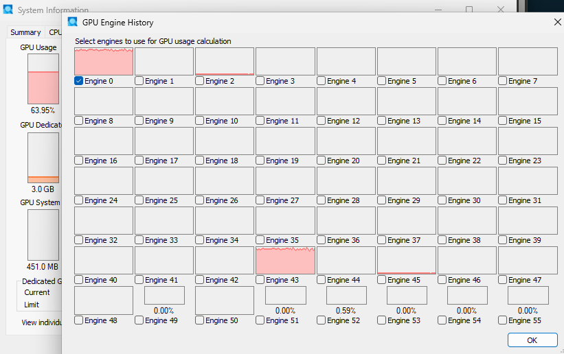

    At this point (v17.11) the GPU % overall calculation just seems unrelated to the engines.
    The engines show as 90%+ (doing Folding@Home), but the GPU Usage % overall is still 65%. I've tried selecting all the engines that are 90%+, and just one, and it's always 65%, as if there's an invisible engine being included.
    And I'm not sure what's going on with display of that last row.
    Task Manager is currently a more reliable GPU % graph. Maybe Process Explorer could take some detail from that.

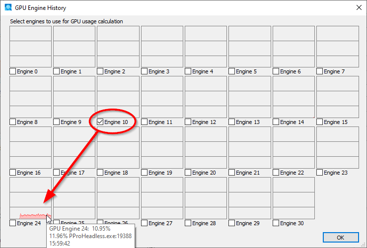

    Same bug present in updated ProcExp version 17.06 (Build time: Tue May 28 17:50:44 2024): in my case I need to check "Engine 10" to get live monitoring "Engine 24" under "GPU Usage".
    Screen attached.
