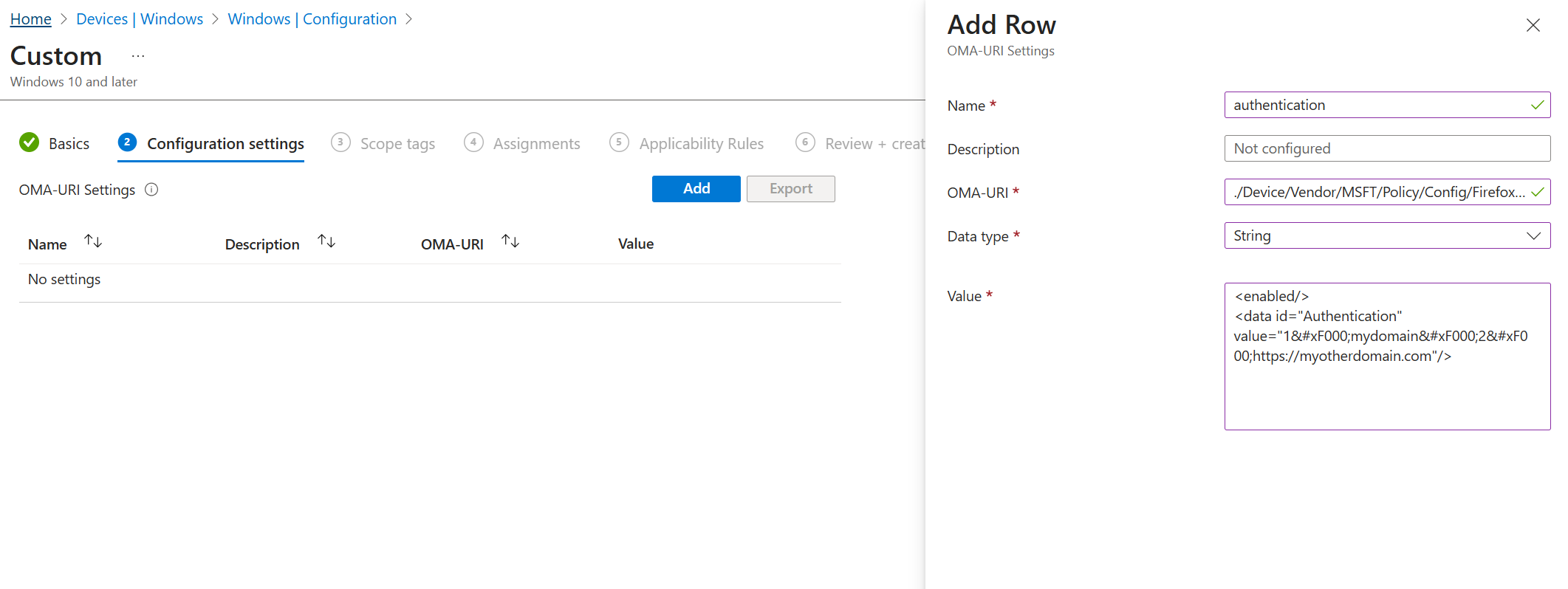

  1. Prathista Ilango 515 Reputation points Microsoft Employee
    2025-10-14T19:41:32.9633333+00:00
    Hello TechUST,
    Hope you have sorted this out. If not, suggestion is to deploy separately because for Enterprise policy configuration, importing ADMX and creating a configuration profile is the most straight forward option.
    For preferences, you can use custom OMA-URI.
    1. On Intune Portal -> Device -> Windows -> Configuration -> Create policy
    2. Select Windows 10 and later -> Templates -> Custom
    3. Go through the wizard and add OMA URI like below, OMA-URI: ./Device/Vendor/MSFT/Policy/Config/Firefox~Policy~firefox~Authentication/Authentication_SPNEGO
      Value(String):
      <enabled/> <data id="Authentication" value="1mydomain2https://myotherdomain.com"/> User's image
    This should help with your requirement. You can script the entire thing into a single deployment as well, but this is more straight forward and easy to monitor.
    Refer to: https://mozilla.github.io/policy-templates/#authentication
    https://support.mozilla.org/en-US/kb/managing-firefox-intune
    Also refer to: https://learn.microsoft.com/en-us/intune/intune-service/configuration/administrative-templates-import-custom
    Hope this helps!
