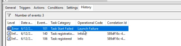

I am registering task in Windows Task Scheduler with settings "Run whether user is logged on or not" and "Do not store password. The task will only have access to local computer resources." enabled.
When task triggers it is failing and in history of task I am seeing error "Launch Failure".
In event viewer, I am seeing error as below -
Task Scheduler failed to log on "\1_TEST_Task" . Failure occurred in "LogonUserS4U" . User Action: Ensure the credentials for the task are correctly specified. Additional Data: Error Value: 2147943726.
Task Scheduler failed to start "\1_TEST_Task" task for user "************". Additional Data: Error Value: 2147943726.
1_TEST_Task - This is my task name.
When I uncheck "Do not store password. The task will only have access to local computer resources." , task triggers successfully and not having any issues.

  1. Harry Vo (WICLOUD CORPORATION) 80 Reputation points Microsoft External Staff
    2025-07-04T03:22:00.35+00:00
    Hi @Sagar Salunke ,
    The error you're encountering (2147943726 / 0x8007052E – ERROR_LOGON_FAILURE) happens because you're using a domain account with the "Do not store password" option enabled.
    This option uses a special logon method called S4U (Service-for-User), which only works with local accounts. It doesn't support standard domain accounts, even if the task doesn't access network resources.
    In order to solve this problem, you must register the task using a local user account (i.e., a user created on the local machine), if you really want to use the "Do not store password" option. This is a Windows limitation by design.
