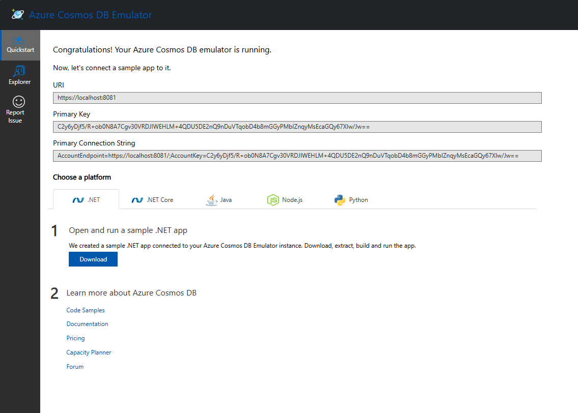

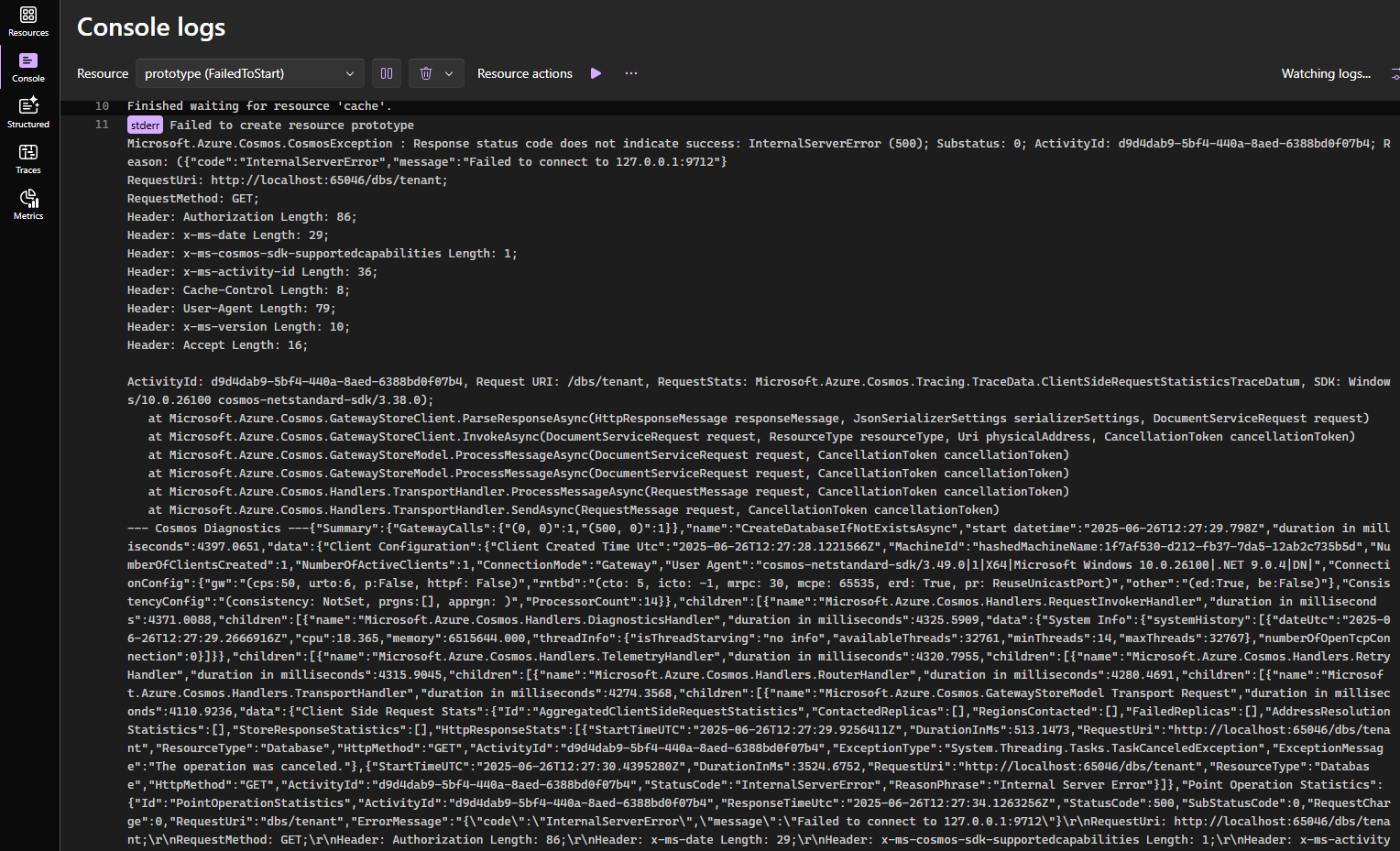

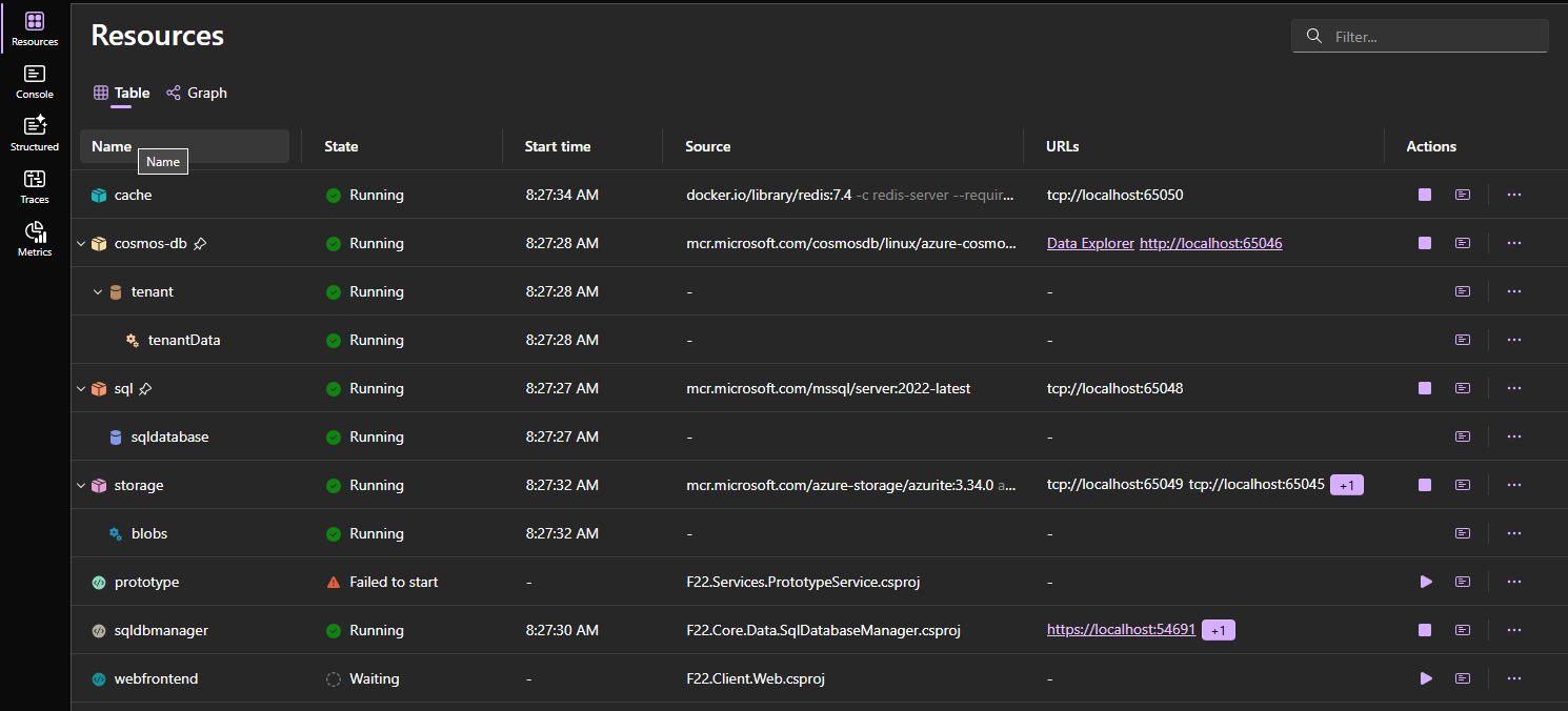

My program.cs is below. When I start the app up with the container creation commented out everything comes up fine. Uncomment it and I get the error, Failed to connect to 127.0.0.1:9712. I know that is the Cosmos DB. The dashboard that comes up with Aspire shows that both the database and the container are healthy (see below). However, if I select the Data Explorer, it shows no container has been created and fails in the same way if I try to create a container manually.

    As my question stated, everything comes up fine if I don't create a container at startup. However, bringing up the Cosmos dashboard and attempting to manually create a container fails with the same message. This was all running fine before the 9.3.1 Aspire update after which it started failing. I've already checked and there are no other processes using that port and the AppHost is already waiting on the Cosmos DB to start up.
