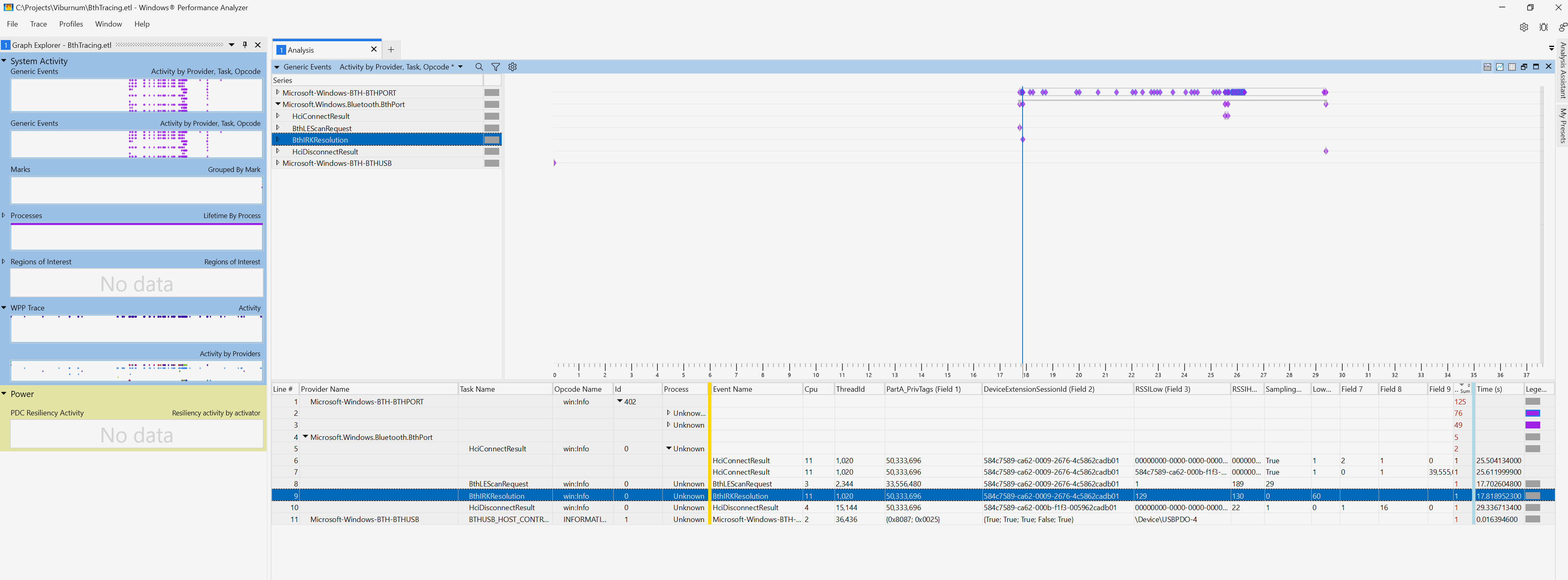

According to logs of the Windows Bluetooth Stack, captured using this tool when this issue occurs and analyzed in the Windows Performance Analyzer (see screenshot below), it seems like the critical event to await is an internal EFW event called BthIRKResolution but that event is not available at the API level. Assuming BthIRKResolution relates to a background Windows task to resolve the random address of the peripheral using the IRK exchanged during pairing, then what event at the API level would indicate Windows has resolved the RPA of a peripheral that we can await before GetGattServicesAsync() can be successfully called?

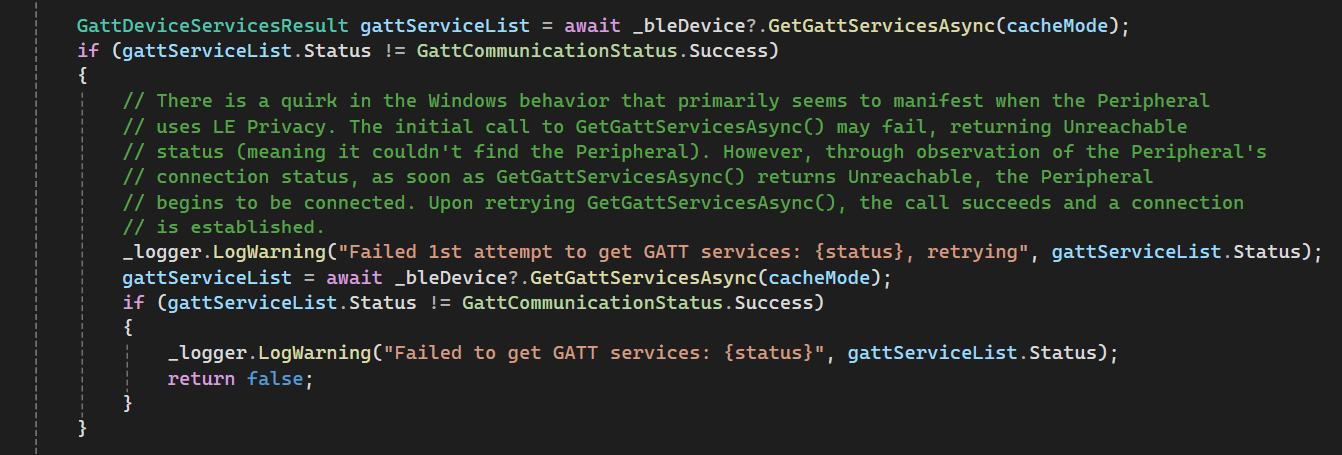

For reference, here is the C# code we have as a workaround to this behavior with some additional context of what we believe is going on in the Windows background.
