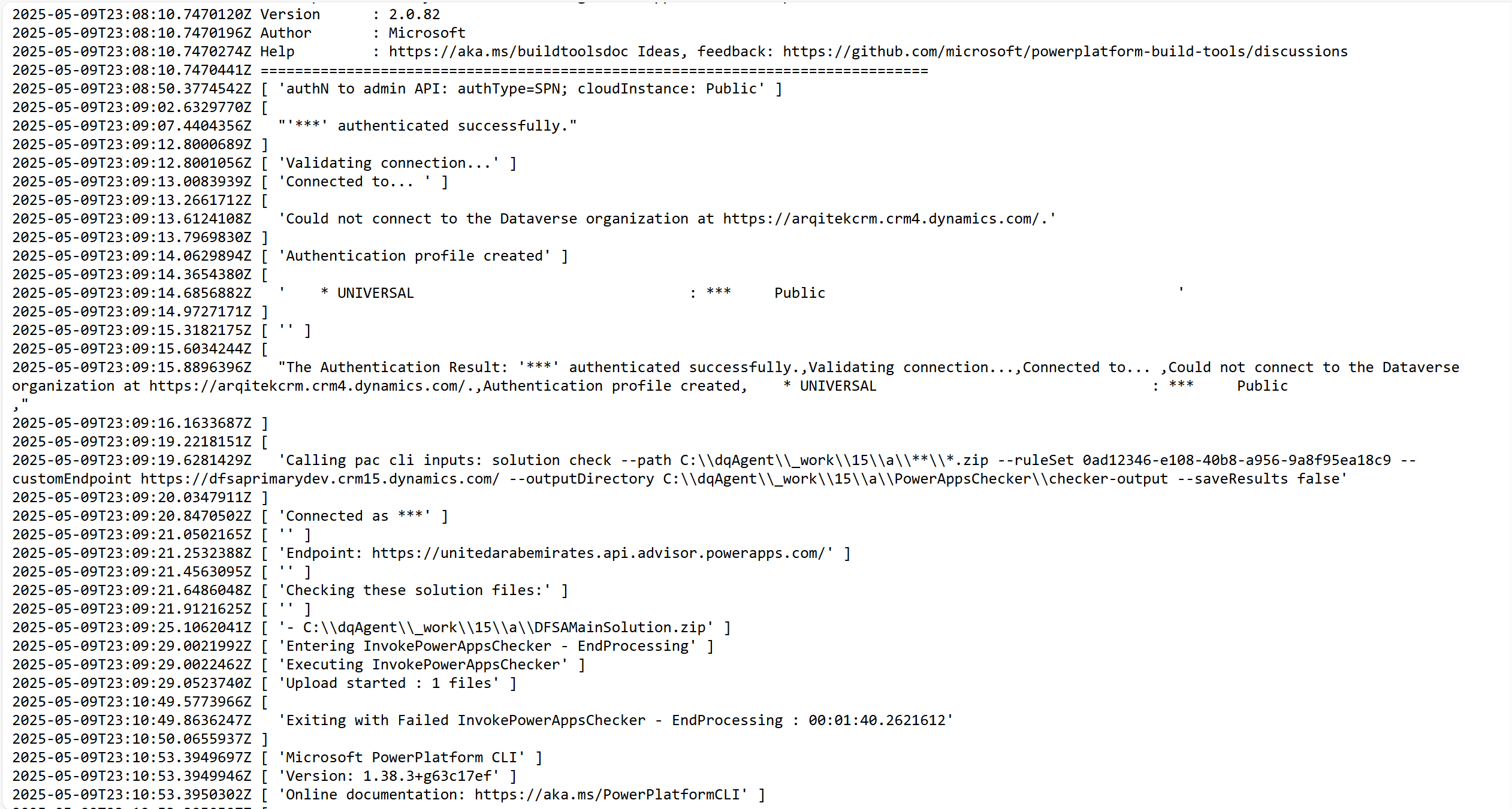

I have an existing export pipeline for our solution. It has been running without issues until recently when the failure rate increased due to the platform checker step exiting with an unclear error. It is clear that the error has nothing to do with the solution itself (based on the logs). It is however unclear what is causing the error on platform checker because it only runs successfully at night. I have attached screenshots of the logs:

    I’ve reviewed the logs you shared, and it looks like the Power Platform Checker step is failing intermittently with the following error:
    Error: A task was canceled.
    Exiting with Failed InvokePowerAppsChecker
    This usually points to throttling or network timeouts, especially since you mentioned the step works reliably at night.
    I also noticed this recurring failure:
    Could not connect to the Dataverse organization at https://arqitekcrm.crm4.dynamics.com/
    Which again indicates that the CLI couldn't reach the Dataverse instance before timing out and canceling the task.
