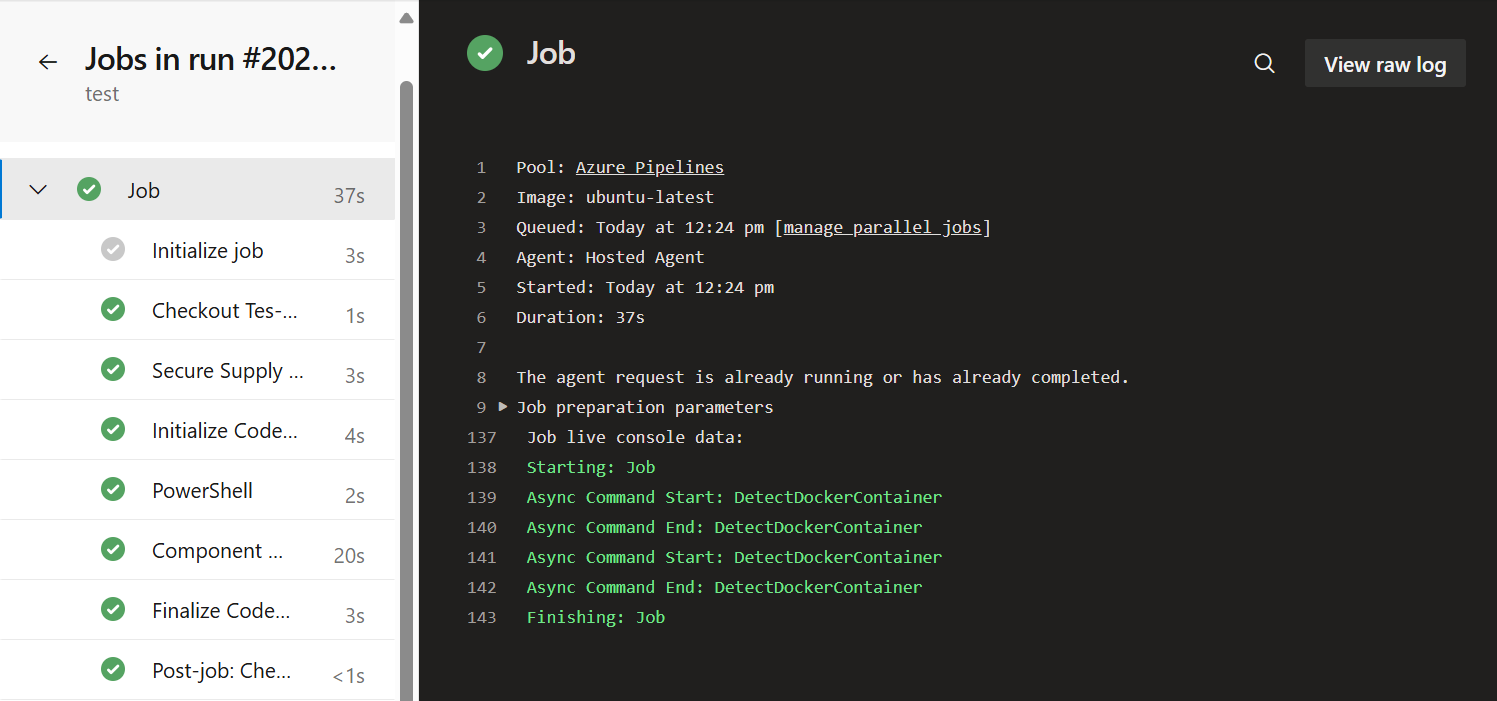

    Later, create a new pipeline along with the existing yml file delivery-plan-access.yml then store your token under variables by naming it System. AccessToken because System. AccessToken is a special OAuth token automatically provided by Azure Pipelines. Add your token value and then save and run the pipeline.
    Here is the output: image

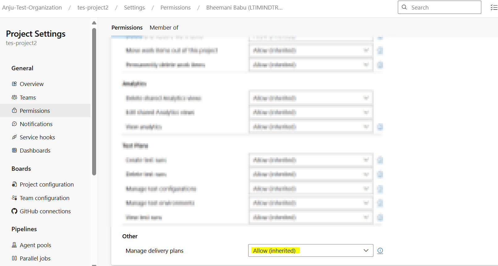

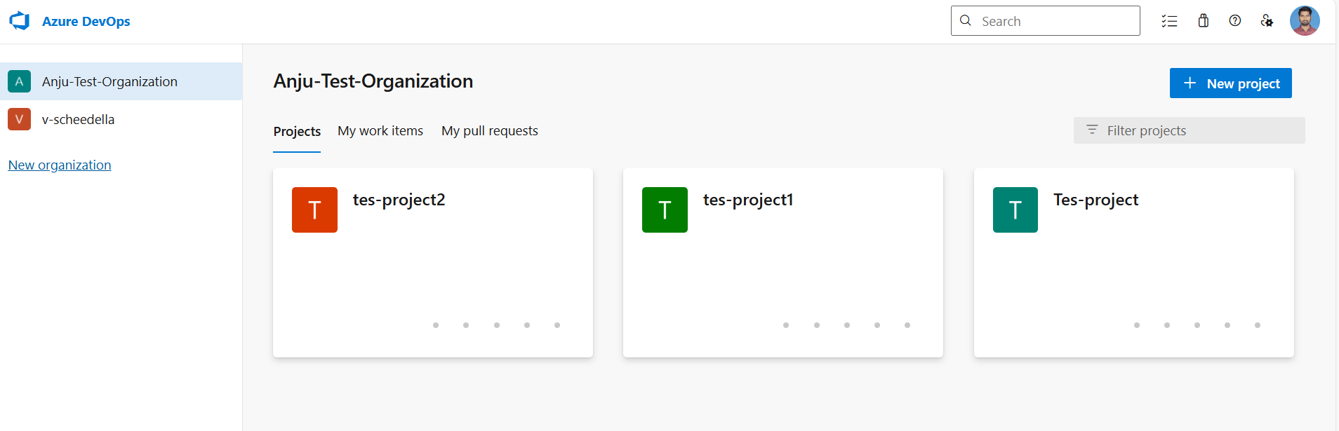

    I have created three test projects under the same org after the pipeline executed the managed delivery plan has allowed successful entry into three projects at a single attempt.
    Here is the output for the permissions status: Screenshot 2025-05-17 164204 Screenshot 2025-05-17 163945 Screenshot 2025-05-17 164020
    Screenshot 2025-05-17 164115
