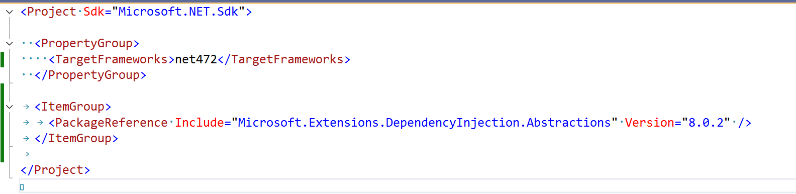

I want to build a project with target framework net472, and this project has a reference to "Microsoft.Extensions.DependencyInjection.Abstractions"

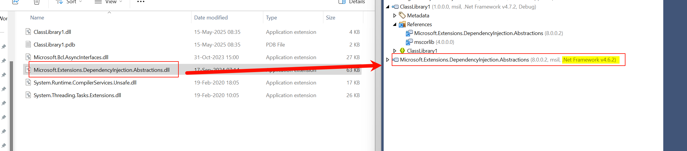

when I build the project, the output result contains the package reference with net462 dll, User's image
while I want to use the netstandard2.0 dll, so I can make the project compatible with other projects.
The main point is that I want use the netstandard2.0 dll of the reference package in the net472 target framework, how can I make it without changing the target framework of this project?

    While .netstandard 2.0 projects are compatible with both 4.7 and .net core, they may do this by multi-targeting frameworks. Generally this is done when they have conditional compile or framework dependencies.
    If a .netstandard 2.0 project is used to build a 4.7 solution, its will use 4.7 compatible target if one is defined. If used in a .net 8 solution, it will use the .netstandard 2.0 version.
