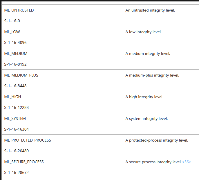

  1. RLWA32 51,831 Reputation points
    2025-05-02T17:07:55.71+00:00
    You could use WinEvents to track changes to the foreground window. The event callback could determine if the process owning the foreground window has an integrity level greater than medium. If it does, the assumption would be that your low level mouse hook will not be called until the foreground window changes to a lower integrity level process.
