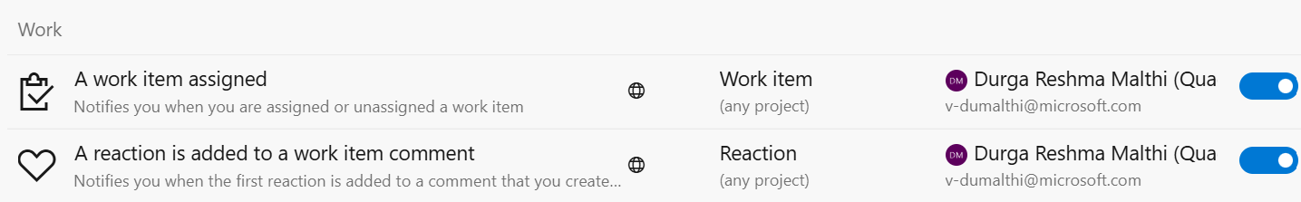

    6. Go to Azure DevOps -> Project Settings -> Notifications. Review the notification rules you've set up for build completions, failures, etc., and ensure they are configured to send messages to the correct Teams channel. Also, verify that you are subscribed to the correct build events (success, failure, etc.).
