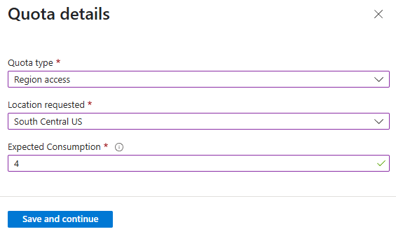

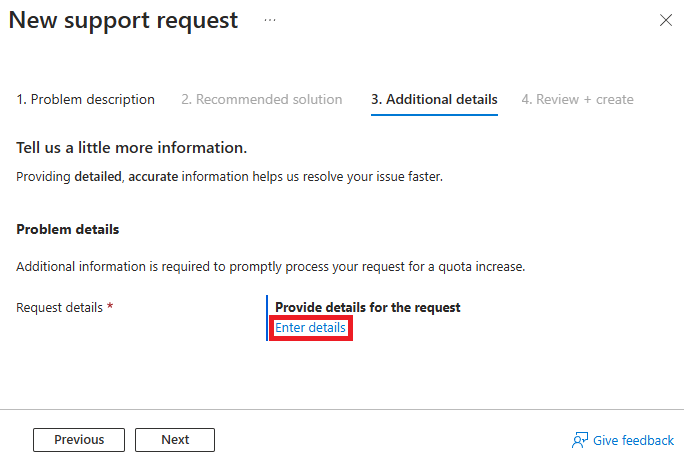

    8. Now you should be on Additional details tab. Click Enter details
    9. Select Region access or Region access with zonal dependency, select Location you need (South Central US), enter number of cores, click Save and continue
    10. Finish filling out Additional details tab, click Next, review and click Create. You should receive an automated email within a few minutes.
