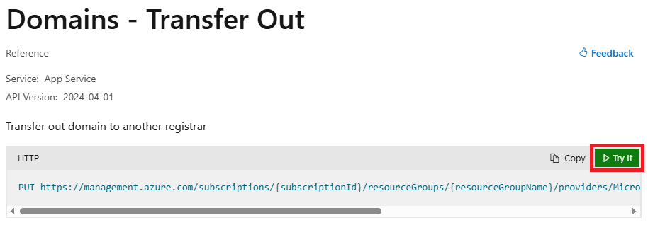

  2. TP 118.4K Reputation points
    2025-04-30T01:02:44.0133333+00:00
    @Jose Flores @Flatts To request auth code please navigate to link below:
    https://learn.microsoft.com/en-us/rest/api/appservice/domains/transfer-out?view=rest-appservice-2024-04-01
    Click green Try It button and sign in using Entra ID account with Owner role.
    On right, fill in domain and resource group, scroll down and click Run.
    If successful it should show status code 200 and if you scroll down a bit you will see json output with authCode in it. The code is in between the quotation marks.
    Please reply back with your results, whether positive or negative.
