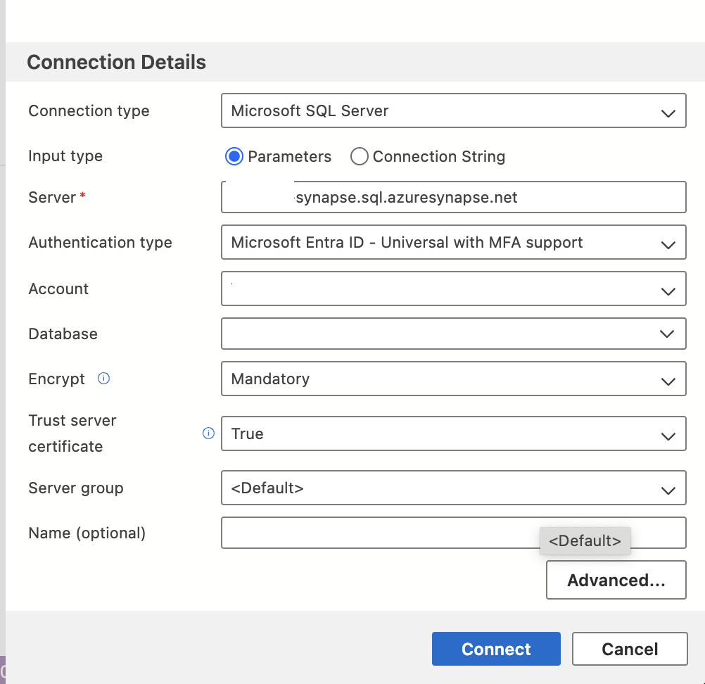

After completing the setup, I’m trying to log in to my Azure Synapse Dedicated SQL Pool using the email ******@companyname.com with Microsoft Entra ID - Universal with MFA support as the authentication type. While the same setup works perfectly on Azure SQL Server and Azure SQL Database, the login fails on Synapse Dedicated SQL Pool with an error related to 'Service Principal - login failed'.

    If you're using SSMS or Synapse Studio, ensure you’re connecting using Azure Active Directory - Universal with MFA and not a service principal.
