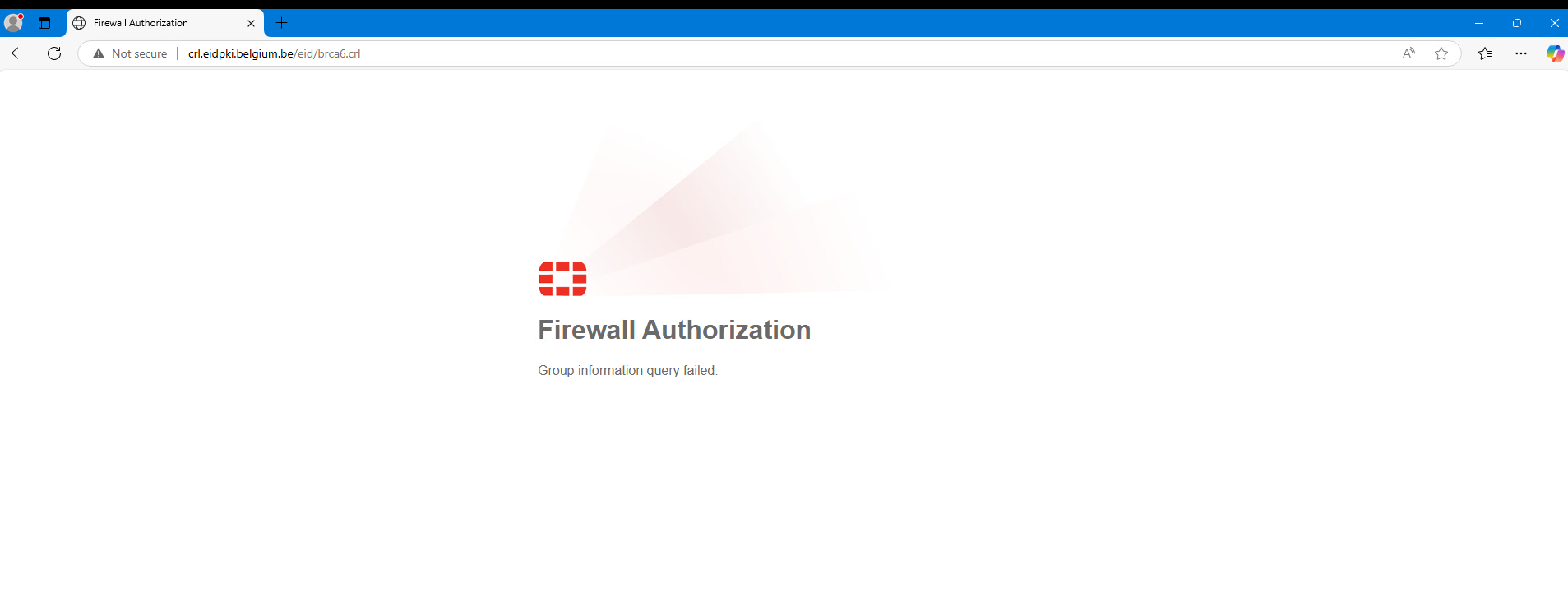

    To try and get more details, I specifically allowed this SA to log in interactively and logged into the server with it's credentials.
    Then, when trying to access the CLR and OCSP's URL I would get a nice firewall error:
    image (1)
    I don't know exactly why my regular user could get through but not the Application Pool nor the SA. As far as I know, the firewall doesn't care about users, only IPs. But it looks like it's not quite true.
    What I know though, is that the System Engineers added an exception that allows the server's main IP (not the one binded to the IIS Website) to access the OCSP and CLR's domain and that the IIS can now properly validate the certificate.
