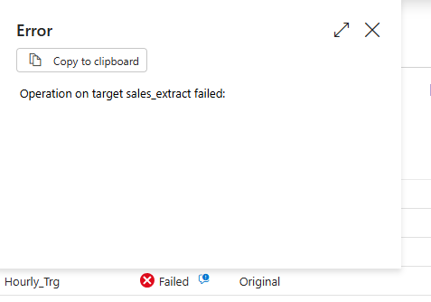

Issue Description: Pipelines are failing in the Synapse environment without any specific error message or detailed logs. The pipelines run as usual but fail silently, and no error or warning is provided that can help diagnose the root cause of the failure. This unexpected behavior makes it difficult to troubleshoot or identify the issue.
Reproduction Steps:
Trigger a pipeline in the Synapse environment.
Observe that the pipeline fails without showing any error message or failure details.
  1. No logs are returned, making it impossible to pinpoint the cause of the failure.
Expected Result: The pipeline should either complete successfully or return a meaningful error message that provides information about what went wrong.
Actual Result: The pipeline fails without any error message or logs, leaving the cause of the failure unclear.

    Hi @Chandra Boorla
    Thanks for the quick steps to address this issue.
    After a couple of scheduled refreshes, the pipelines completed successfully without any further errors. As a temporary measure, I’ve applied a Retry configuration. However, this behaviour remains highly unusual and unexpected, and the exact root cause is still unclear - no relevant logs or diagnostics were captured in the Synapse environment.
    So far, we haven’t observed the issue reoccurring, assuming it may have been an internal or transient issue on Synapse's end. Would you recommend any further steps to help identify the root cause or prevent future occurrences?
